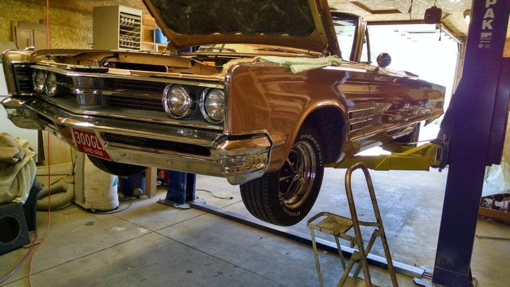

I love having to use a ladder to top off the master. :)
how tough can bleeding brakes be. please.
Real easy with a lift. :) Mine has been royal pain and I have bleed plenty of brakes in my life. I have been a gravity bleeder, no dice with the 300. I finally drew the air out with the vacuum pump from the rear brakes.
