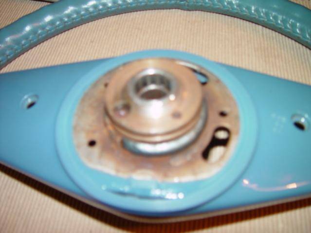

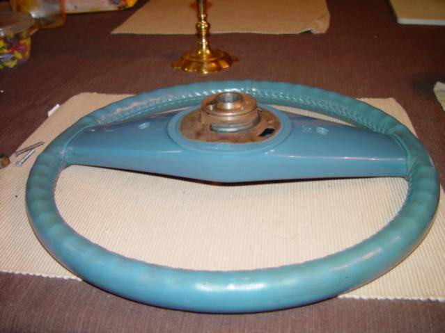

You might be able to find a green leather wrapped one on a regular column out of a Charger/Magnum or whatever. A little lathe machining and it'll bolt right on to the T&T column.
Before....
Machining....
One of none Formal Ny'er with a blue leather wrapped (Hemi) steering wheel.:poke:

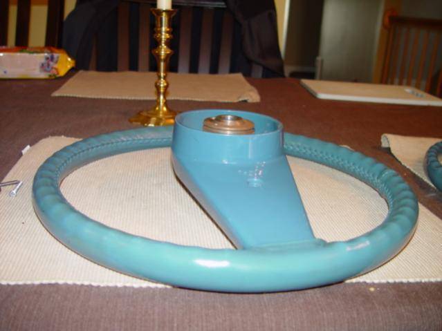

Scrap the aftermarket steering wheel idea on a T&T column.......no one makes one that will work.
The only way a 3 spoke will work is if it has the slots like my blue steering wheel. Of course you would have to machine the hub like this one too.
