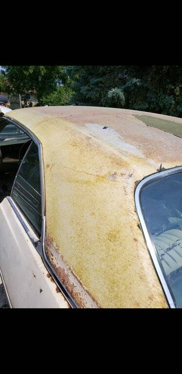

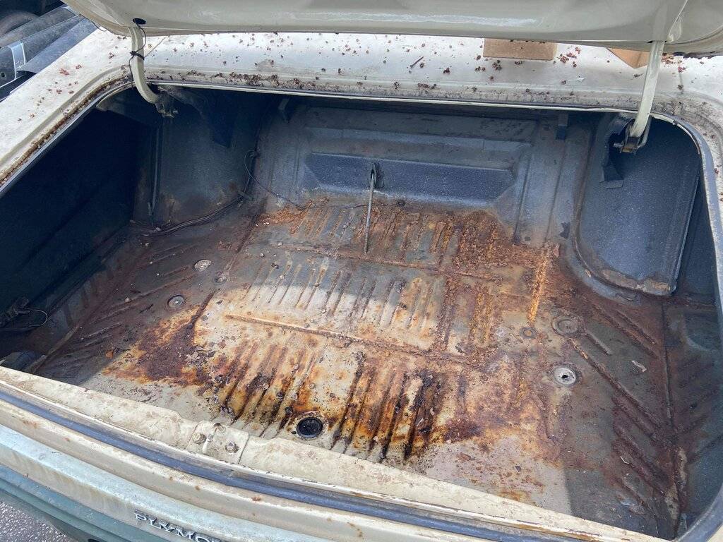

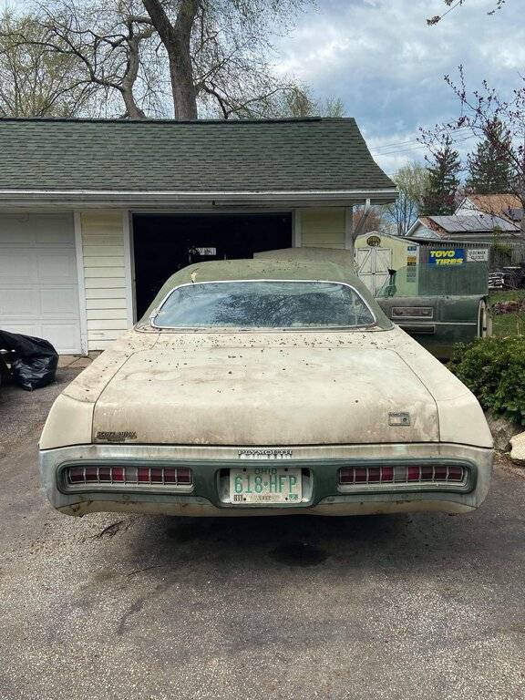

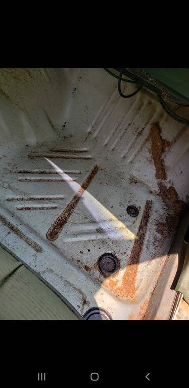

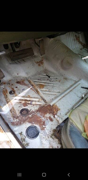

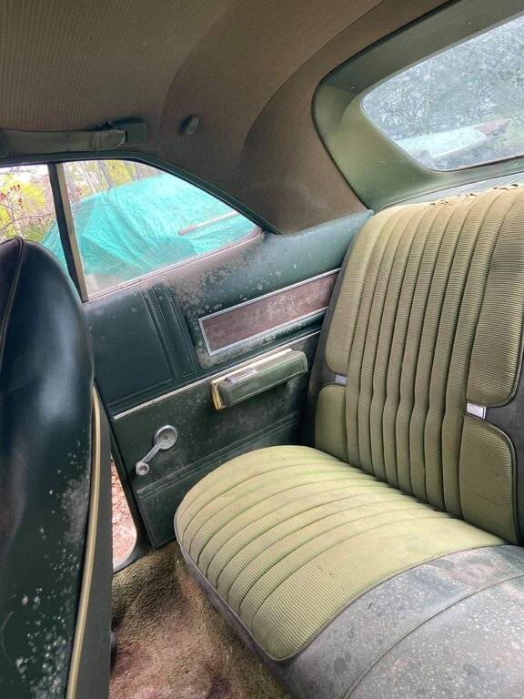

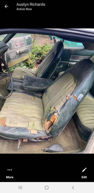

Few pictures of the part's car it has all the door panel's and front buckets i need. A solid trunk floor and front floor pans and trim mine is missing.
It's really surprising you were able to find a 71 Sport Fury Brougham as a parts car for your Sport Fury GT in that kind of condition no less! Is your GT also a Brougham like the one @CanCritter restored to the max?

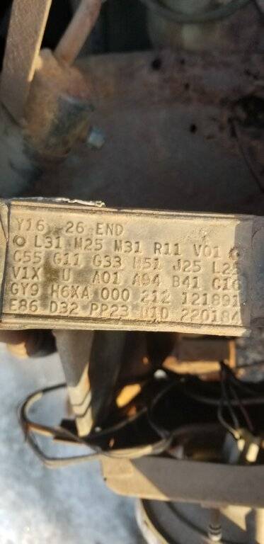

No I don't believe so on my GT the interior was removed a long time ago and I don't know what happened to it. So no broadcast sheet at all wouldn't the upper quarter roof skins have holes for the emblems if it was a Brougham edition?
Wouldn't the interior code on the tag be a indicator of the Brougham package? I presume it wasn't coded as a package on the tag?
Brain fart this morning correct it's code for black vinyl buckets i wasn't even thinking about that at all when answering Steve!!!
Your GT is a vinyl bucket seat car, black in color:

Your parts car is definitely a Sport Fury Brougham - I don't think there was a Brougham emblem on the C pillar for the parts car. I know there wasn't one on my 70 Sport Fury Brougham.

Also if your parts car had a tag, for the interior it would have read H5F7

As a side note, H stands for "high line", M for "medium line", L for "low line" and E for "economy" model line.
Since your GT is a high line model, it has the H as the first letter in the interior code and the Brougham models were also high line. If your seats were an option in a regular Sport Fury then they would have been coded M8XA for example (apparently seats like yours would not have been identical in a regular Sport Fury since the grains would have been different between the bolsters and the seat inserts themselves whereas the seats in your GT should be all non-grained - hence the M8XA:

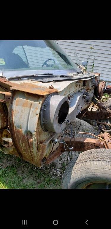

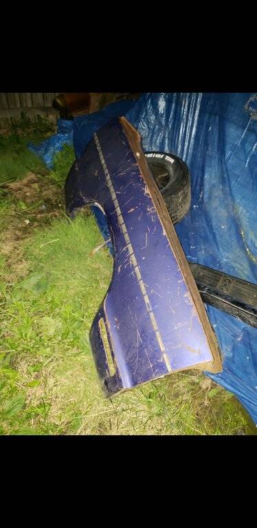

Finally got the part's home big help from @Trailer Park!!! Roof and floors are perfect and the cowl also. And also he helped with getting a 71 Mood GT fender since my passenger fender was a 70. And there was some extra goodies in the car also!!

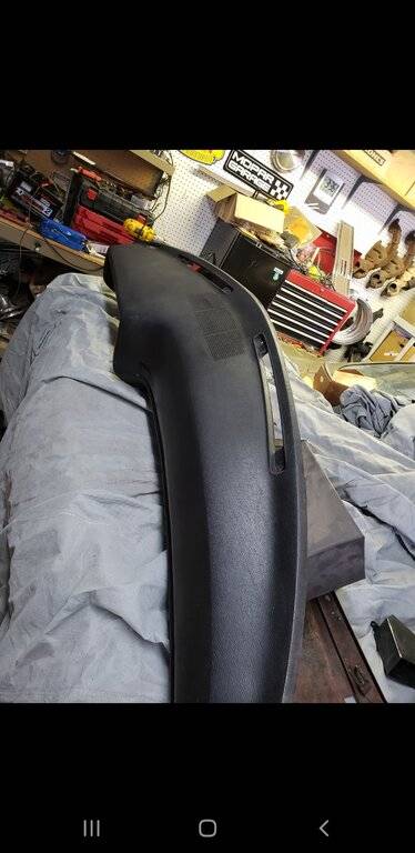

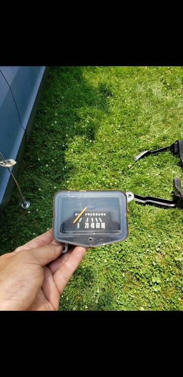

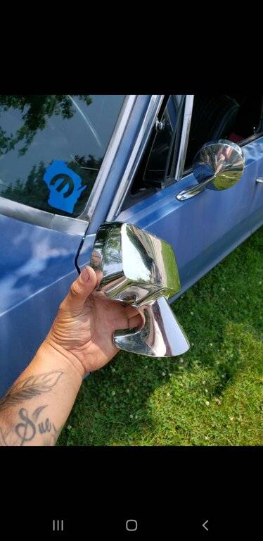

Finally got around to fixing a few things up for the GT. Dash pad repainted the frame and started on the speedo found a better grill and a decent rear bumper for fun tested the taillights today.
