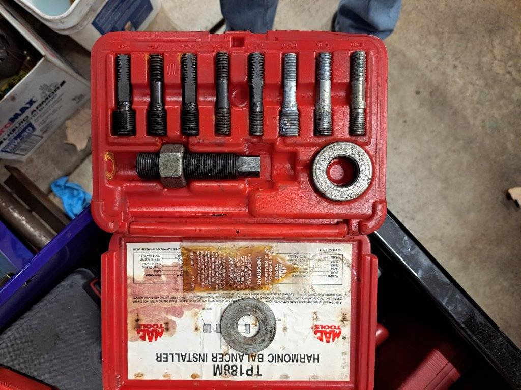

Perfect. Those work very well. I always stocked one and sold dozens.

You can rent a balancer installer from your local rent all or parts store.
I tried that once and all they had was metric threaded. A bolt and nut with a couple washers with a touch of grease has done the same thing. Yea, it doesn't have the nice thrust bearing washer, but it works well. Hard to justify buying one more fairly expensive tool that I use every few years.
I'll have to tell you the Mac Tool dealer story sometime.

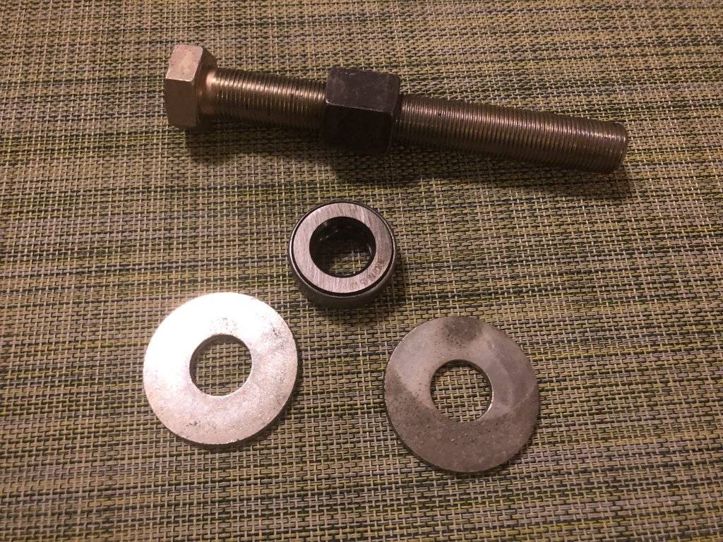

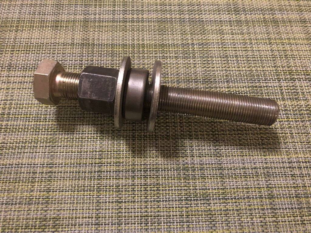

I just made my own tool, I was lucky my work had the hardware, I just needed to get the bearing.
The 5 black adapters in the MAC set above are standard. The silver colored ones are metric. It sounds like you didn't get ahold of a good set. :poke:
