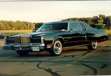

9 1/4 Sure Grip 3.21 ratio. He found a 76 Gran Fury pursuit in a wrecking yard and moved over all of the Police goodies to his NYB, torsion bars, cooling, steering, differential etc, put a set of 78 Pursuit wheels with road wheel centres and trim rings. A total sleeper NYB.
His car is so cool in so many ways...here's a pic of it.

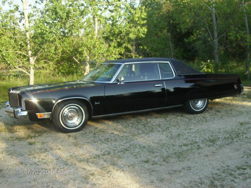

Bobs right, you posted a photo of a friends car and your car....is that the same car or another beauty
I thought it could of been you...somebody posted a group picture some time ago with about 5 formals in it. Two or three of them were black.
