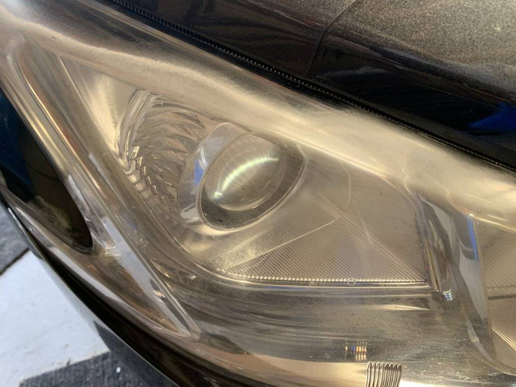

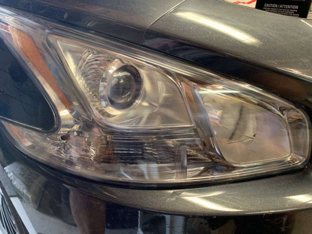

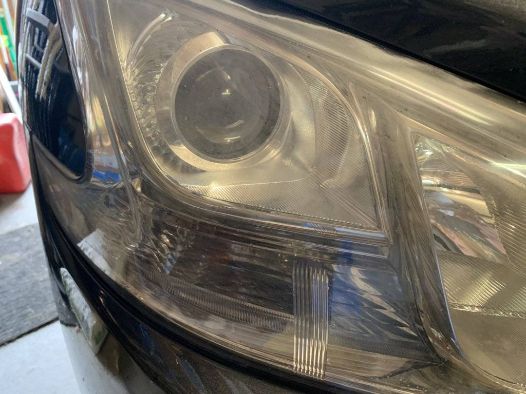

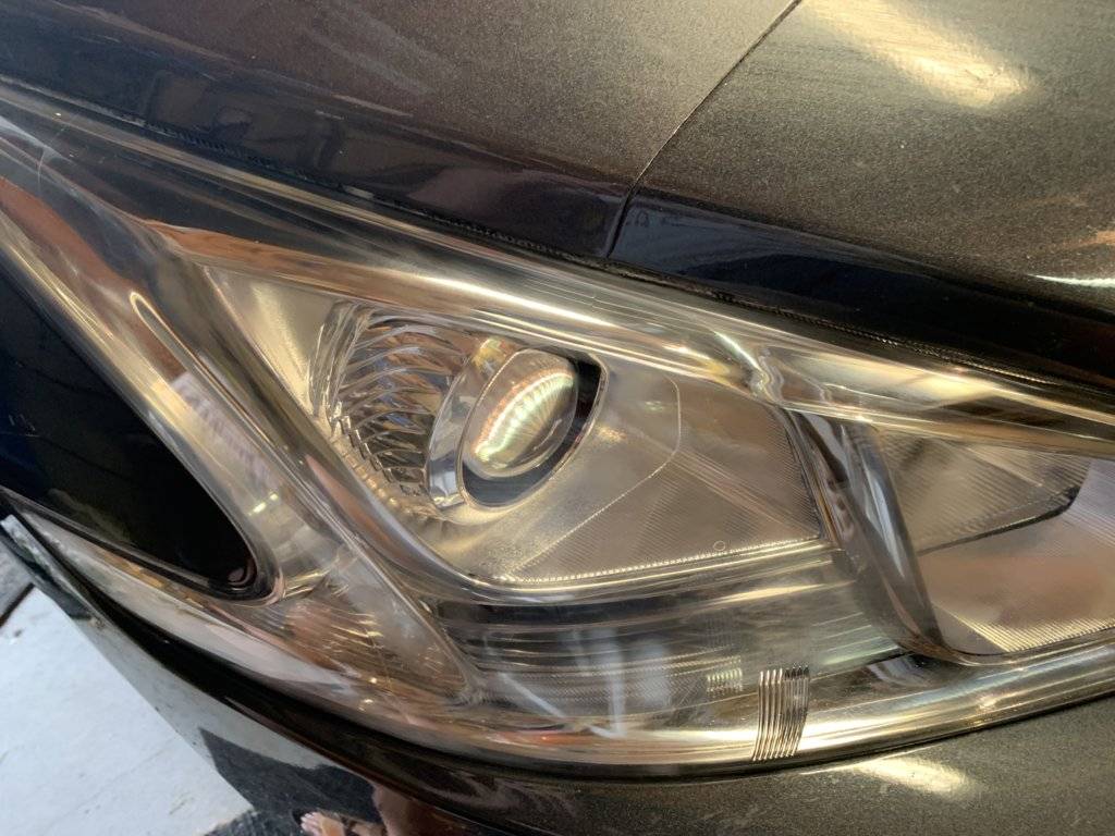

Recently I have noticed the headlights on my wife’s car were fogging over. With the shorter days coming I felt it was time to do something and to be honest I was a little apprehensive. I purchased one of the 3M headlight restoration kits and went at it.
Well it turned out great and I am quite pleased with it.
It’s supposed to work well on plastic lenses such as taillights. I do think you can do your own variation though. The kit includes 500, 800 and 3000grit pads. As well there is a very fine rubbing compound and silicone wax. Can’t wait to try it on something else.
