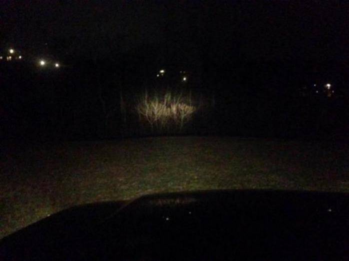

This is comparison pics, before and after, on my SUV. I went with 5000K. White, with NO hint of blue!
(These are actual pics, of my SUV. Bulbs were Sylvania silver star ultras, they were $56 for the pair. The second pic is of the HID conversion. 5000K temperature. They are extremely white, but no blue tint. I hate blue headlights.) It is literally like night and day. The bulbs are 35w lows, and 55w high. They are 100% legal.. At least in PA, WV AND Ohio.
Stan... You can buy them in America. Only problem is, they were made in China, and you will just pay 4 to 5 times as much, for the same thing. Didn't see the point.
Also, those headlights, have helped me not wipe out Bambi, at least 50 times. Haha
