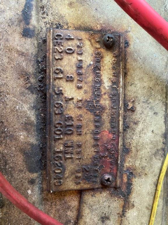

Help with fender tag decode on this 68 Newport
NoSmokingNewport
Oct 11, 2021
4
0
Nashville
Can someone help decode this? Really just needing to know interior color. Getting ready to order carpet. Thanks!
Would be your TRM codes...
T - E = Economy interior package
R - 1 = Cloth/vinyl bench seat
M - Q= Turquoise colour
So most likely had a matching turquoise carpet.
CE23 = Chrysler (economy)Newport 2dr
PNT Ww1 is body paint color , white
C01 is your build date Dec 1, 1967
383 2bbl
auto trans
For this car C01 is December 1, 1967
WW1 is roof paint white and body paint white
u1 is sold car=someone ordered it
X2 is tinted windshield
2.76 open rear
8.55x14 WW tires
remarkable in that is has few options.
