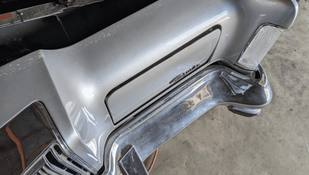

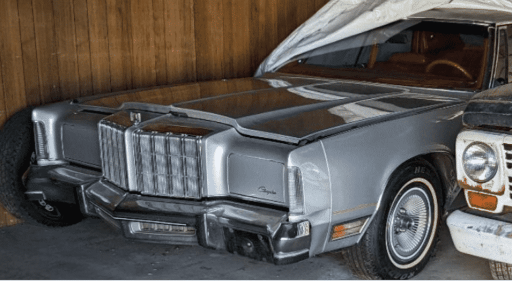

I want to try to adjust the hidden highlight doors on my 1978 Salon. I am assuming they can be adjusted since until a day ago they were fine for the four years I have been caretaker..
This first photo was taken one hour before the one below it. Spring startup, however the headlight doors did not completely close after actuation.
BEFORE
ONE HOUR LATER

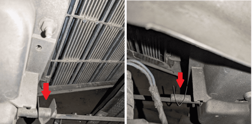

Next two ARE from my car, specifically where torsion rod connects to each door.
I was hoping that "clip" looking "V" shaped thing on each door could be how adjustments/torsion rod removal are made?
They both have slightly different orientations yet the doors are both in the exact observable misaligned position (won't close completely). Wishful thinking maybe they can be adjusted?

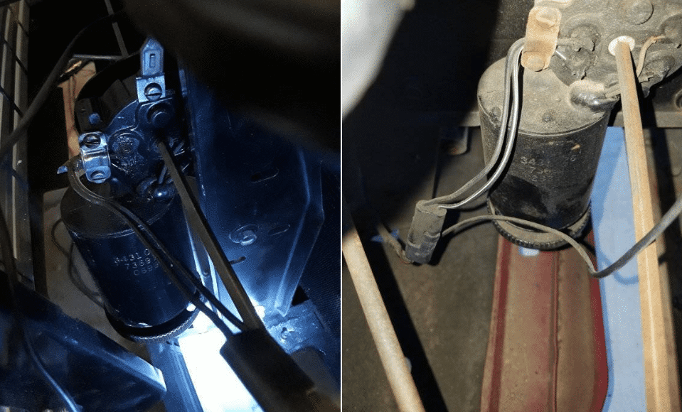

There is a "square" shaped, metal bar (the "torsion rod") that runs thru the motor and operates both doors together. Mine just apparently started to NOT rotate sufficiently to completely close the the doors.

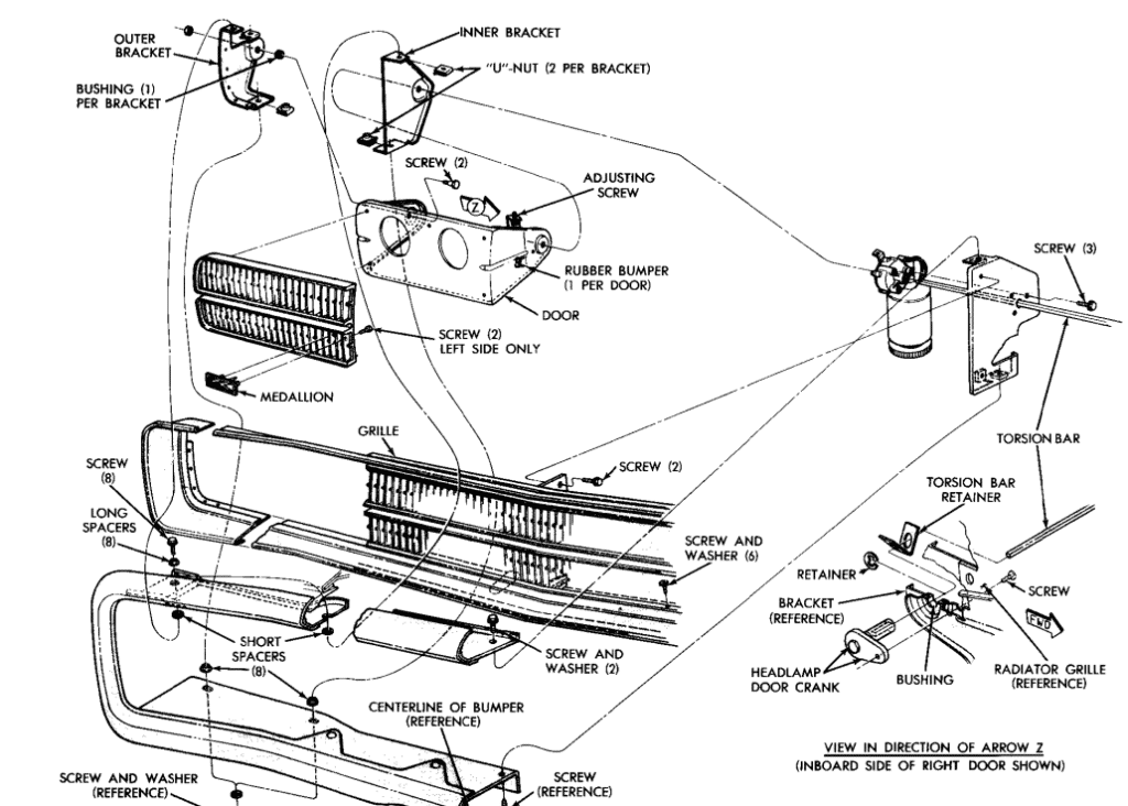

Pictures below are NOT from my car but represents the style/look on the setup.

My car is 10 years older than yours, but I aligned my headlight doors by adjusting the stopper and twisting the torsion bar. Mine just didn't close far enough, but by twisting the torsion bar I was able to get them to close tighter.

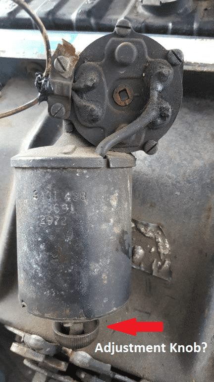

In that vein, a new term that comes up is a "manual adjustment knob" that I presume is ON the motor. The context is positioning this knob properly when one replaces the motor.

The "adjustment knob" doesn't adjust. It allows you to open/close the doors by hand. You could still give it a twist and see if it closes more... In which case, those motors aren't that bad to take apart. The problem I've seen in working motors (where the gears and contacts are good) is the bottom bushing gets dry and needs greasing. I had an issue with that with my car with its supposed rebuilt motor. The motor was filled with sludge from the sandblaster (yea, that kind of rebuild) and years of crud. An hours time disassembling/ cleaning/ greasing/ assembly made all the difference in the world.

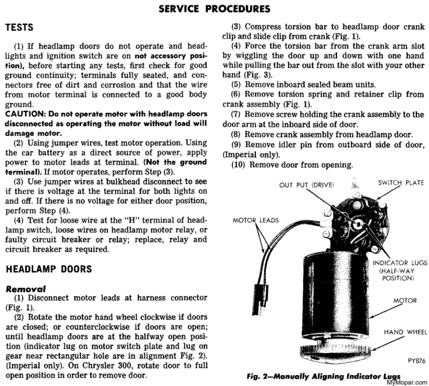

There's a 74 parts catalog on mymopar.com but after looking through it, it appears to be no help at all

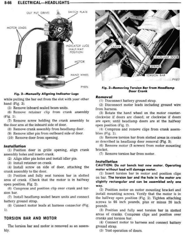

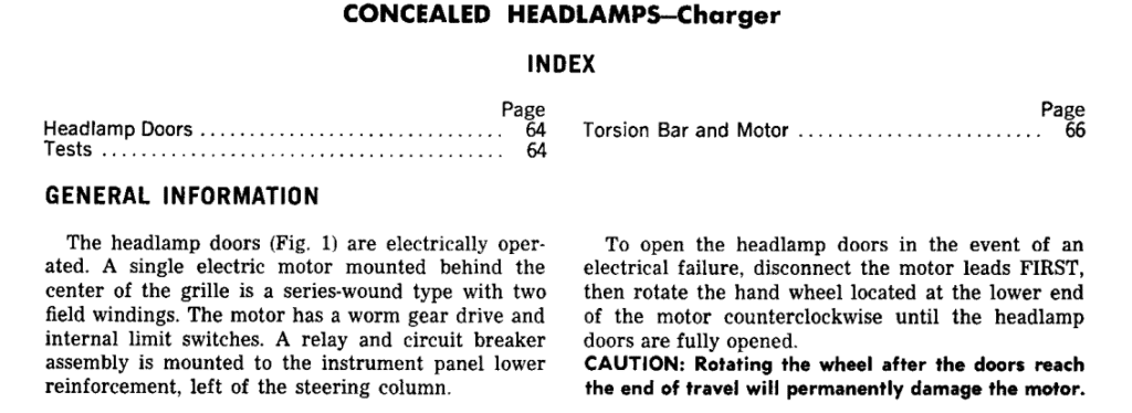

I went to the 1970 Charger manual which uses a similar system - single motor/torsion rod set up. Answer(s) may be there but I gotta study it.
Still gives me hope that a C-body manual would give THE factory answer for our cars. @Big_John and @marko are right on the mark with their guidance.
THe 1970 Chrysler Manual is there. The text resembles the 1970 Charger's, with differences in the names/design features of specific carline parts.

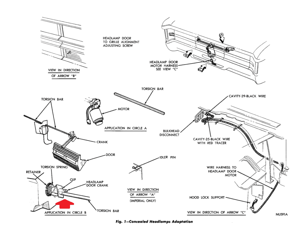

I put a red arrow on that "V" clip that's on my 1978. Its talked about when removing torsion bar FROM the doors. It has specifc instructions for the 300 vs. Imperial as well.

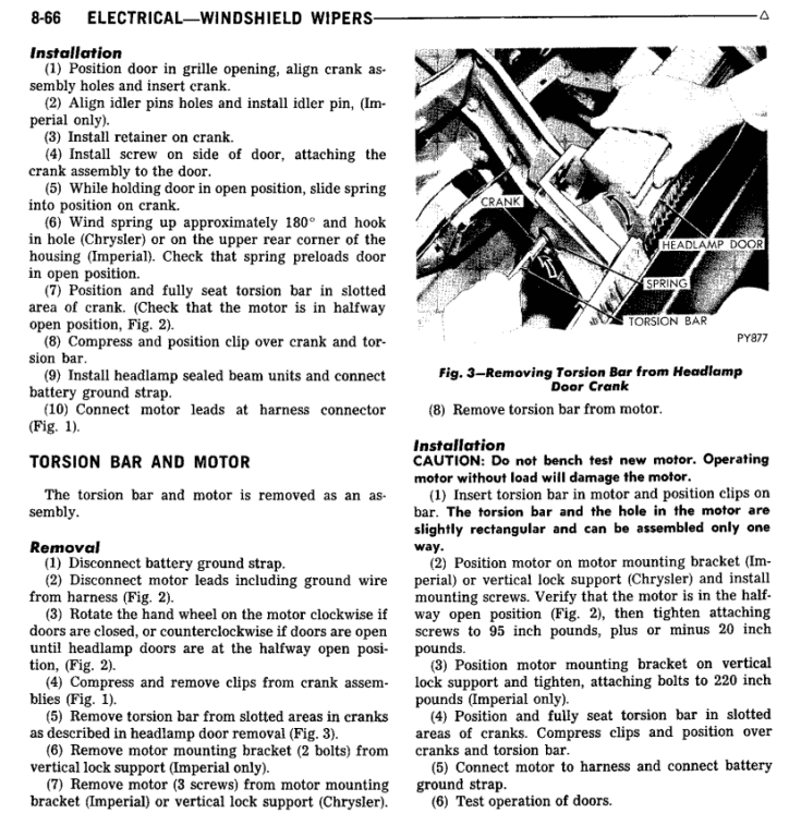

@amazinblue82 my FSM doesn't show any adjustments in the mechanism, other than internal adjustments in the motor. But I don't think that would be the issue here. More likely some play in the linkage.
