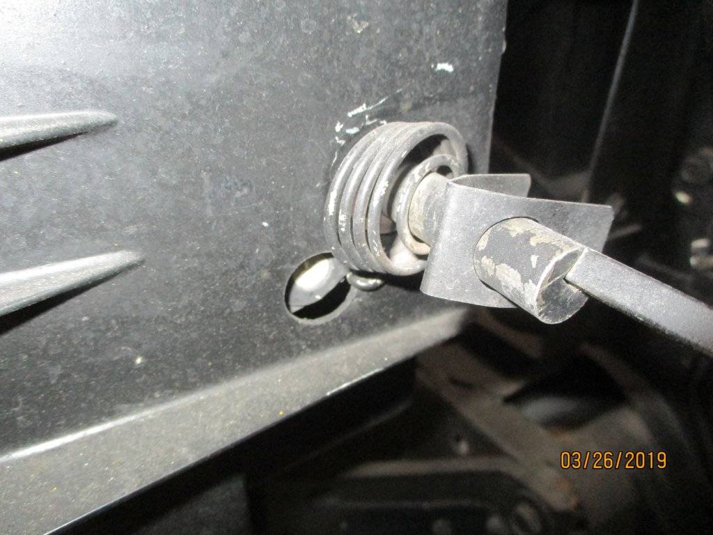

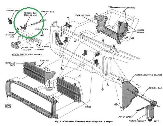

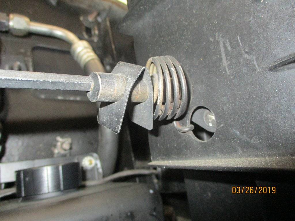

Need 1 "V clip" that holds the spring in place on the hidden headlight set-up.
Used on most / all years and models with hidden headlights, not just C-bodies but also B-bodies.
The part is actually referred to as the "torsion bar retainer clip"
See factory drawing for reference.

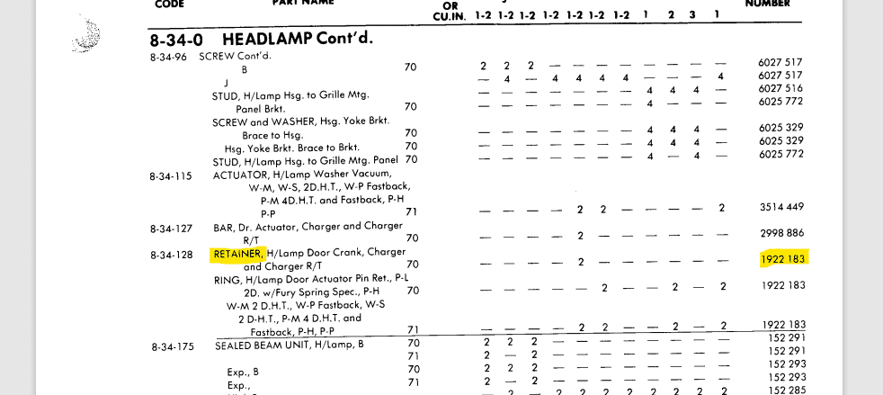

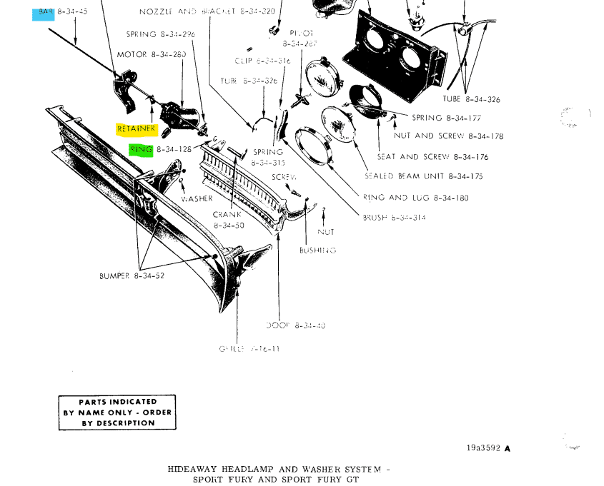

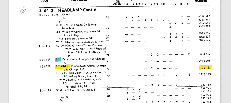

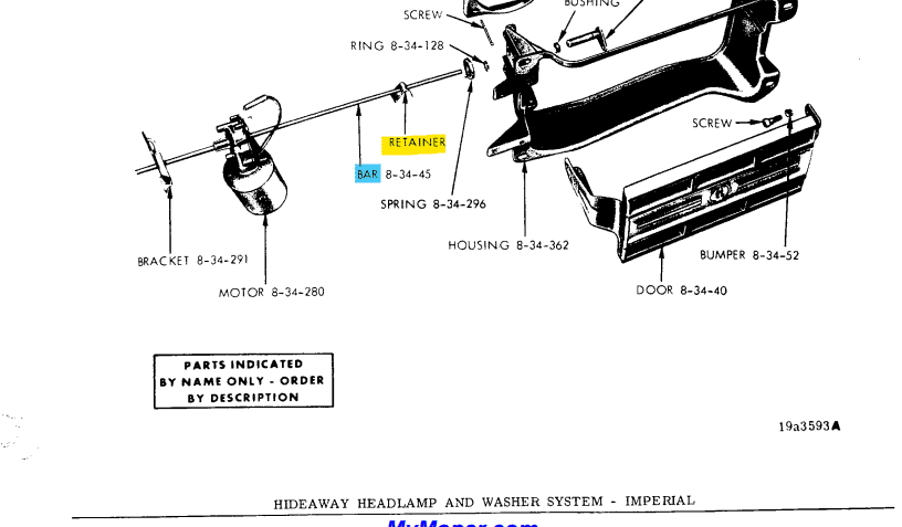

I looked around my various "rare parts" websites, didn't find anything immediately because I didn't know what I was looking for. So I hit the parts book and it looks like that retainer is PN 1922183. Notice that the pic doesn't give a section number for that retainer, but I went to 8-34-128 for the "ring", and found it.
Also, make note of the blue for the "torsion bar". It comes up in 8-34-45 and -127, because they're different lengths and different PNs.
Do a search for 1922183:

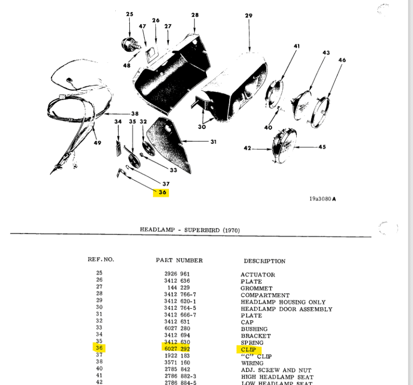

But I then found a different PN for the retainer, 6027292. This one for Plymouths, Chryslers and Imperials. AND Superbird!! Is it the same as 1922183? Probably, but not totally sure.
Here's the Superbird parts. So that means that you could try the 'bird nose" reproduction vendors to see if they have that same thing. I would certainly call Tony's Parts. He knows everything and everybody. But I think 1922183 should work for you just fine.

Responding to this based on the info you provided about the possibility of another part number.
"But I then found a different PN for the retainer, 6027292. This one for Plymouths, Chryslers and Imperials. AND Superbird!! Is it the same as 1922183? Probably, but not totally sure."
Because after some further research in several different model year master parts catalogs believe that the Superbird parts list is a typo. The call-out numbers "36" and "37" in the illustration are most likely mis-labelled / reversed. Not surprising as the Superbird parts lists are well known to have been thrown together hurriedly and contain errors.
From that research it looks that the correct torsion bar clip for ALL cars with hidden headlights use the 1922183 part number.

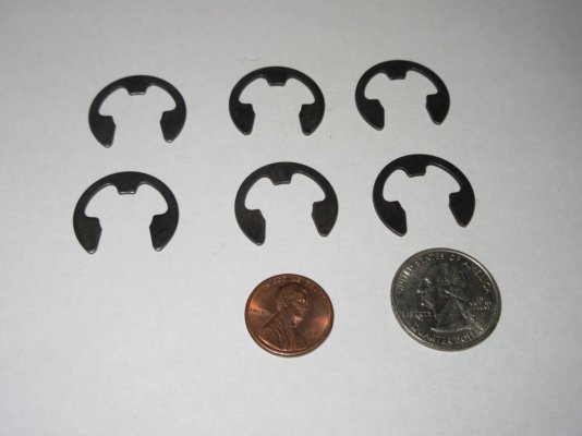

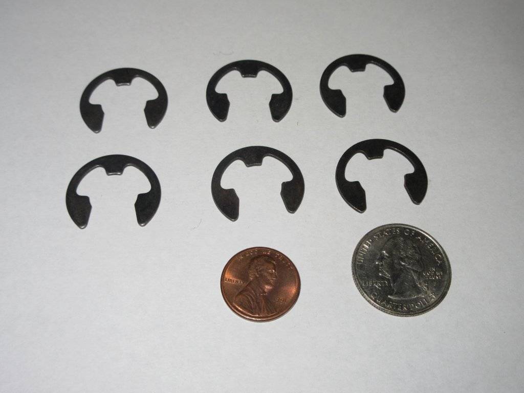

Providing this to assist any others. After going back and forth with several parts suppliers to order the clip listed as part # 1922183, including Central Jersey Motor parts it turns out that the clip they list under that part number is NOT the headlight torsion bar Retainer or "V -style clip"
Instead the part that is labelled 1922183 is the "lock ring". Attached is a picture that shows the clip that is under that part number.
