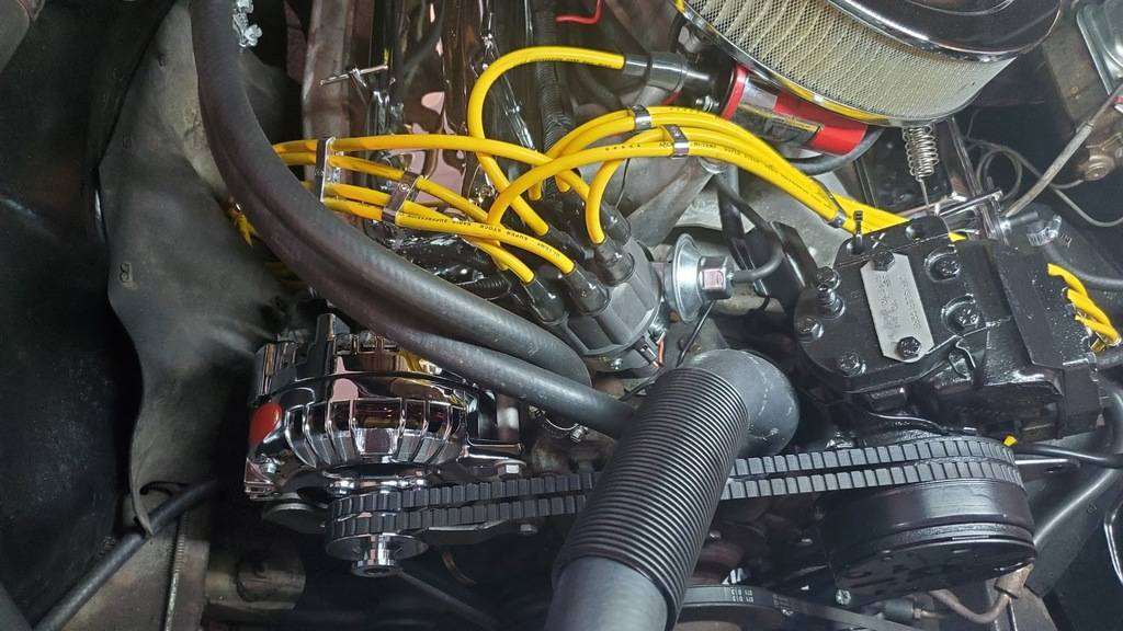

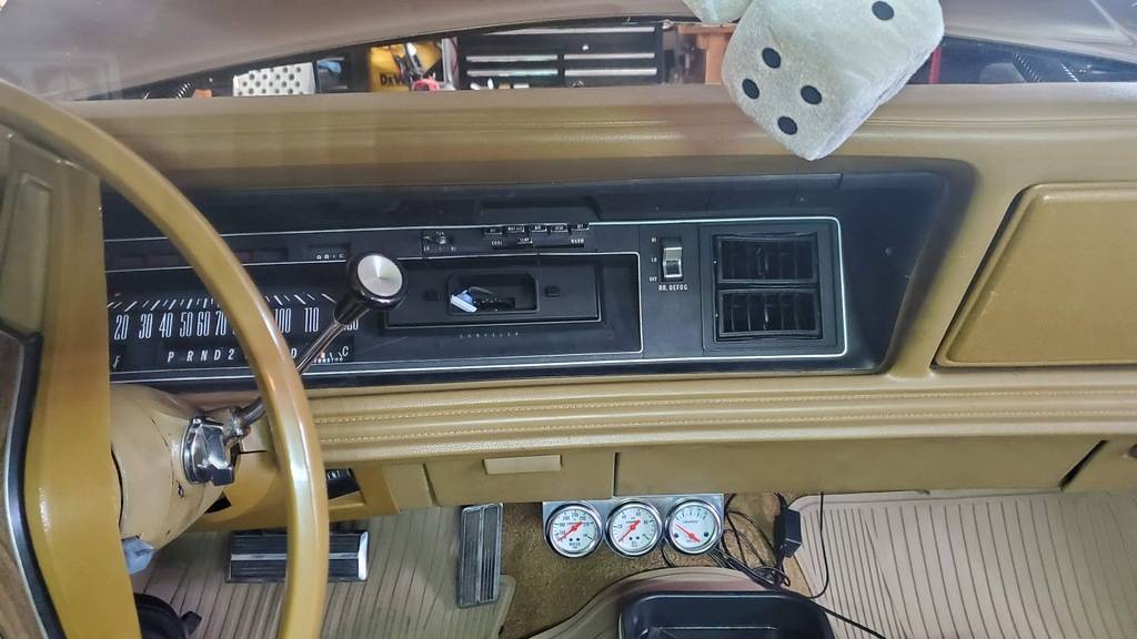

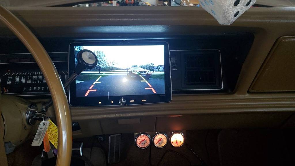

My 73 Newport has 2 12's in the trunk with a 500watt amp and a cap. I installed a 90 amp alternator to handle it and the other electronics I installed, like a 10.1 android tablet that runs my sounds.

Yeah I use my android tablet for movies, music videos and such. I also have a raspberry pi for weird side projects while out driving.
Here is the Alt that I got - https://www.amazon.com/gp/product/B000PDIBX0/ref=ppx_yo_dt_b_search_asin_title?ie=UTF8&psc=1
