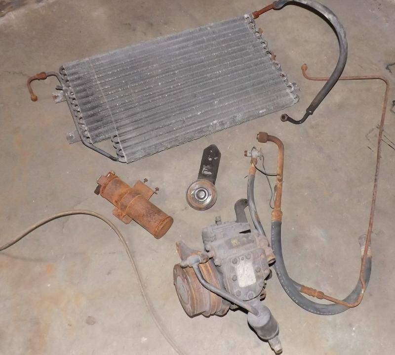

Oh crap, sorry Chris I sold the under dash box today. Umm I still have the engine bay parts, here is a picture if that's of any help. One pipe is missing that travels across the engine. It is L shaped, maybe Detmatt has it?
I agree w/ a newer Sanden compressor, using Bouchillon brackets (~$150). Every mod car you see at shows uses a Sanden. I have bought them for $50 new on ebay (winter) and just saw a new one sell for $85. I would have grabbed it at the starting $40, though I have enough for all my 60's cars now. Aluminum parallel-flow evaporators also boost efficiency and save much weight. I bought an AC crimper so I can make hoses cheap and easy. I recently replaced the old hoses in my 85 M-B. I will put an under-dash evaporator in my old Mopars. You are ahead w/ the factory AC box. Shouldn't be hard to install a modern alum evaporator (ebay) in your box, by adding sheet-metal plates. Might need to silver solder extension tubes thru the firewall, or you can get fittings to go thru (ebay, for rodders). O-ring fittings are easiest to use today. Don't fear removing the climate box. I can remove the non-AC box in my 65 Newport in 20 minutes. I removed the AC box in my 69 Dart fairly easy too, and long ago when I was a dumb kid. So, unless yours is much different, don't fear the job.

So, this is for C body New Yorkers etc. I'm an A/C and heat dummy with only basic A/C education. Would it be better to use a newer type large A/C Condenser and sanden and keep the stock box evaporator? Or just drop in a new evporator assembly=assuming both operate as designed.
hotdog647 is suggesting what most of us are. The under-hood stuff is easy plus more efficieint w/ modern parts, ~$300 if you shop around and make your own hoses. The cabin part would be easy had the PO not mangled the evaporator tubes. Those could be repaired or a new, more efficient evaporator installed in the existing box. Hot rodders do this stuff everday, just visit at any car show and ask questions politely. ebay makes it easy to source parts.
