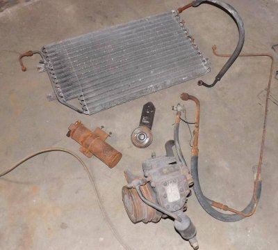

I have most of the 68 system still here including the under box unit, the only part missing is the pipework that laid across the engine as another member here bought that. $100 and its all yours, oh and when I pulled it apart the gas still hissed a little. I'm in NC.
