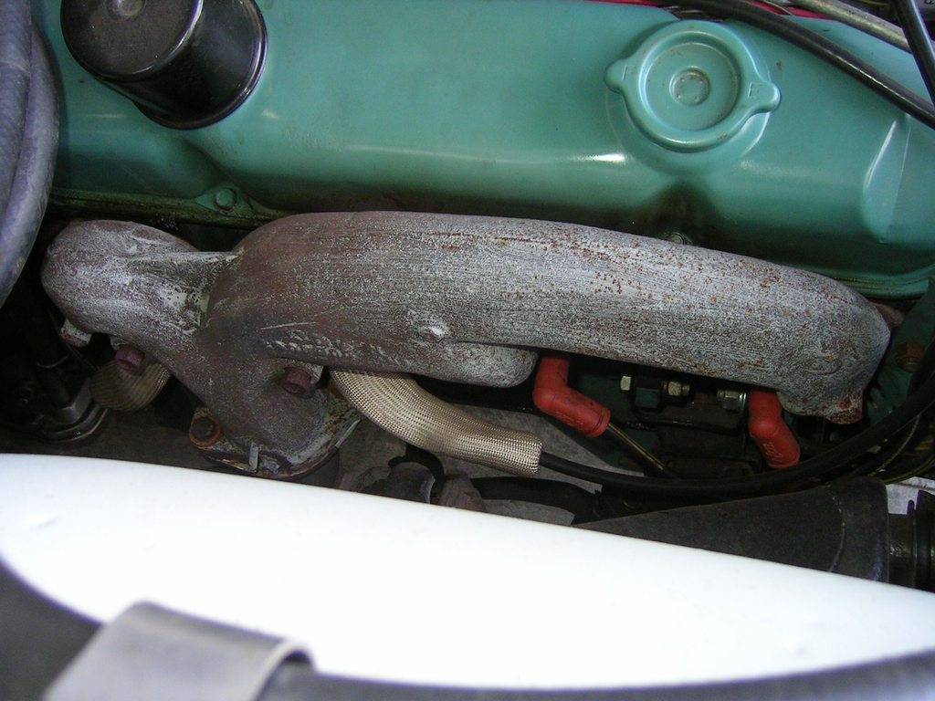

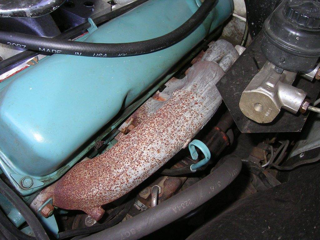

Finally remembered to grab a couple better pics of my poorly prepped HP manifolds with the eastwood coating. ;) I have never touched these up in close to 10 years of having them on the motor, and close to 15K miles with months/years sitting outside in all kinds of weather.
