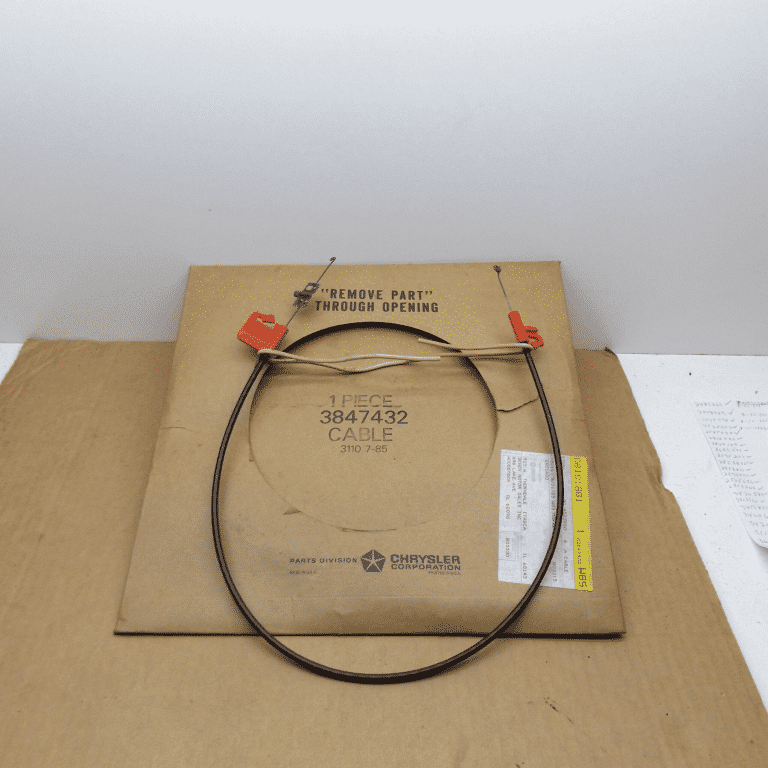

Just having done one for @73 New Yorker here is the easy way to do it. First remove the center dash duct work beneath the steering column.
Next remove the radio assemb. that will give you access to to the A/C heater controls. There are two 3/8th nuts holding them in place Remove them and remove the vac hose controls retainer clip and separate that vac. connection. Tilt the controls down and the temp cable will be visible. Remove the clip, (be carefull as it a hard to find replacements and they love to fall in nooks and crannies not visible) and disengage the cable from the controls. Next disengage the clip at the heater valve and remove temp cable. If you have some mechanics wire, cut a 2.5 foot piece and wrap it through the eyelet of the cable several times several times around the cable housing. Remove the upper part of the Glove box. When removed it you will see the temp cable going through the fire wall. Pull it through gently, the mechanics wire should follow through. Transfer the mechanics wire to the new replacement cable and reinsert mechanics wire through the fire wall and attach to the heater control valve. Snake out the old temp control cable noting how it runs through the dash and install the remaining heater cable. Reinstall the A/C heater controls, Radio and center ductwork. Not really that hard.

commando1 do you have a source for the cable pictured?
