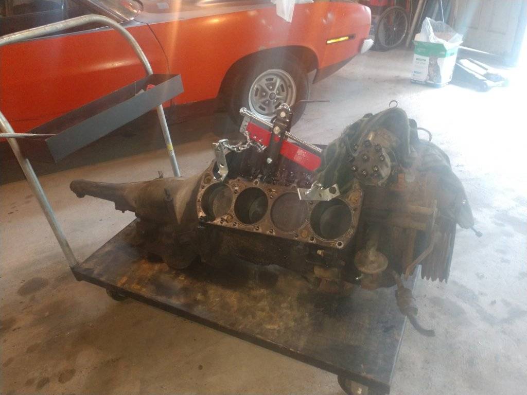

    I'm seriously only gonna redo the drivetrain at this point lol. I've got another car being fully restored already! Here's some pics of the worst cylinders.

    Might, MIGHT, clean up with a hone, but it might be loose if you have to hone it multiple times. Looks like a .020 should clean it up if you can find pistons. You did the right thing, it would have smoked pretty good with the corrosion in the bores. Heads look nice and clean from the pictures. Great car, good luck with the project.

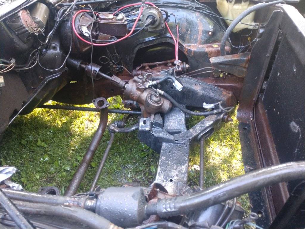

    Thanks for all of the kind comments guys. I pulled the engine/transmission out. Carefully labeling everything. I have a lot going at the moment. But I'm gonna be tearing the 440/727 down this winter. Hoping to have it all back together next summer. IMG_20191005_124602040.jpg
    Also took this time to clean up the engine bay a little bit. I don't wanna dig to far this time lol. I'm sticking to my original statement of doing the engine/transmission at this point lol.

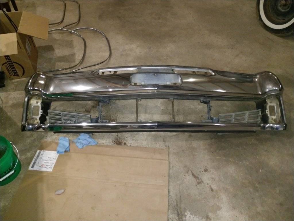

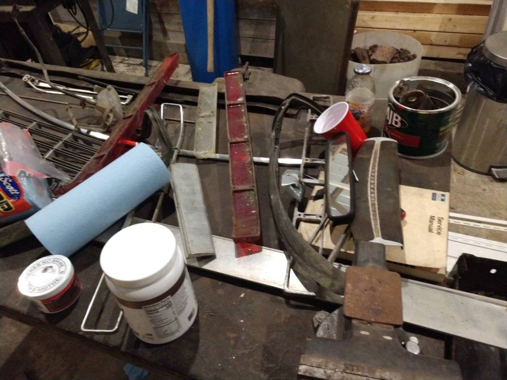

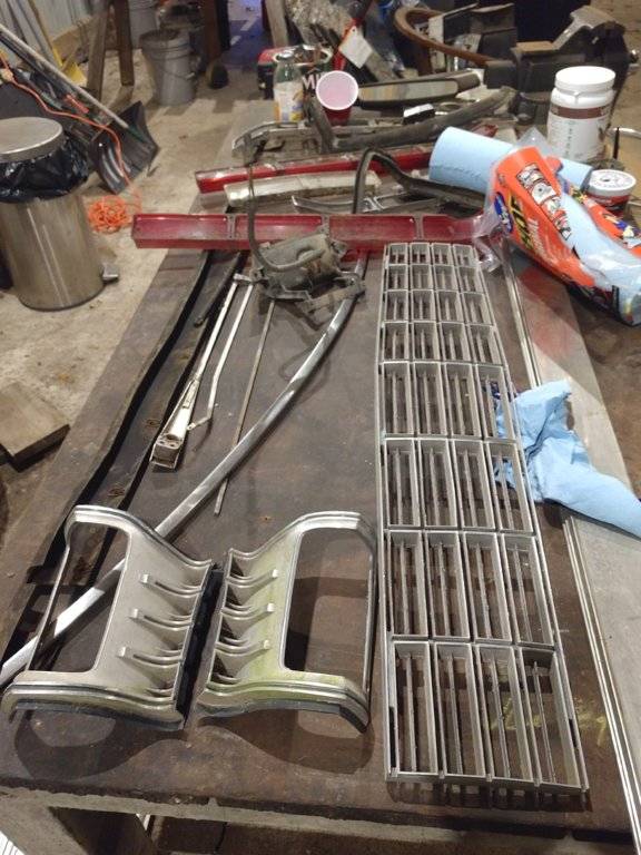

    Just a little update on the car. I recently bought a house so most of my projects have been in hold. But on the plus side the house came with a decent sized pole shed so the imperial will never sit outside again. Spotted a 70 imperial 4 Dr for parts on Facebook a few weeks ago and secured a nearly mint front bumper and a very presentable front grill. As well as a mint set of will trim! Also scored a driver's mirror. And as much trim and hardware as I could pull off. The car was very rusty and heading for a derby sad to say. But it's parts will live on and help me fix up mine. More to come!
