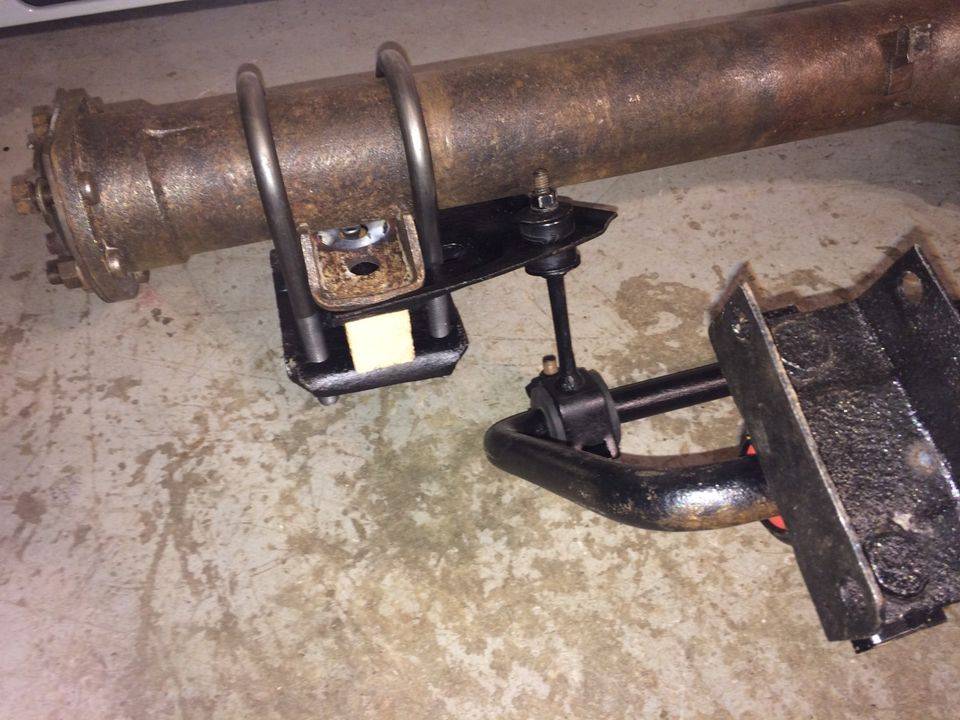

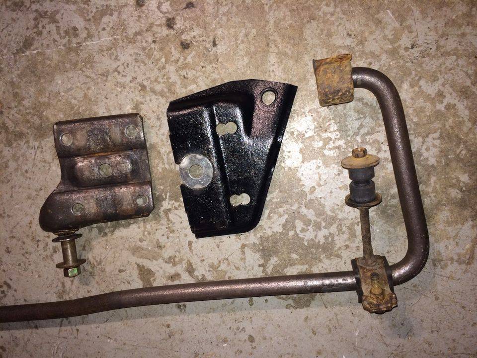

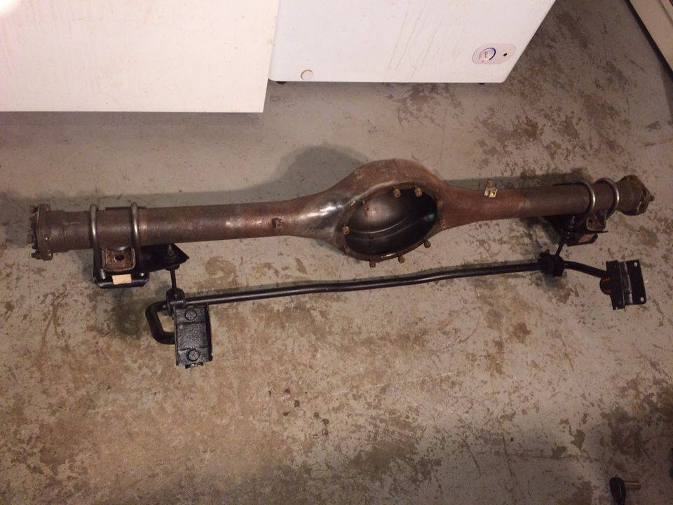

I'll post some pics from my phone in a bit of an ISO delete done on a 73Bbody rear... same ISO contraption
You can see where I tacked in a washer into both the spring mount and the anti-sway bar plate. That pic of the anti-sway bar plate with the additional hole drilled for the Ubolt relocation is before I filed it into an elongated hole to clean it up and then painted it.
*the Ubolts are closer together with the conventional shock plates than the ISO contraption.
Any pre 73 shock plate for an 8 3/4 rear or Abody 8 1/4 as the tubes are 3" The plates from the ISO contraption are too far apart and would require the Ubolt holes to be relocated.
Ok I guess you could relocate the holes or use them as is... I personally like to have the Ubolts close to the springs and axle spring pads. Thus minimizing the potential for any movement of the shock plate.
