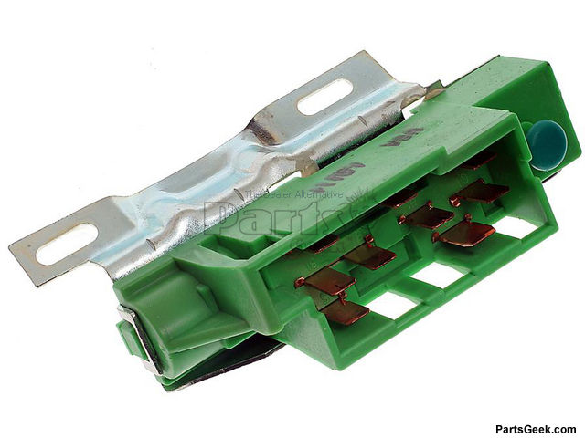

Still haven't got a switch yet since the car is parked for winter BUT I did find a cheaper switch maybe. 1969 Firebird ignition switch looks to be identical. Found it for half the price of the "mopar" switch.
It appears the metal housing will just have to be swapped over.
