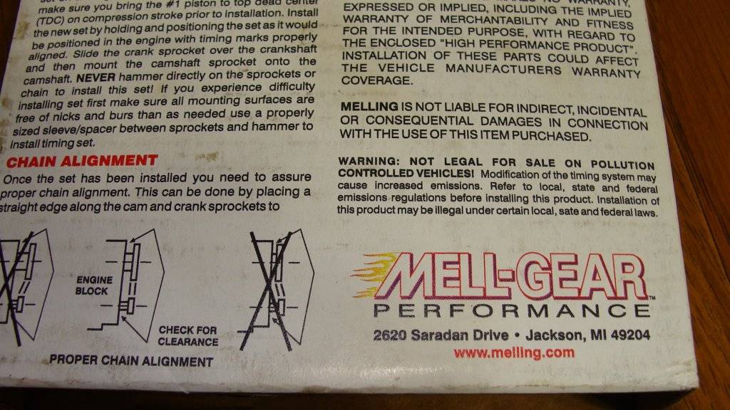

Out of curiosity, was or is there some notation on the box (or a piece of paper inside of the box, loose) which stated the country of origin for these items?

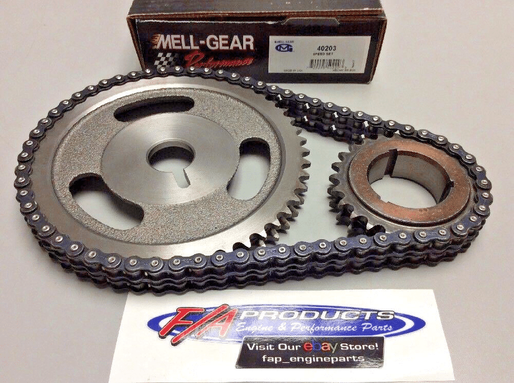

Gotta blow up this pic of the box to see "Made in USA". Lower left corner.
Of course, that doesn't mean the one they ship you was made in the USA...
