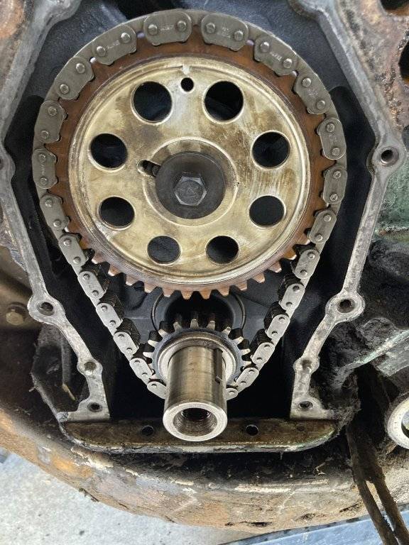

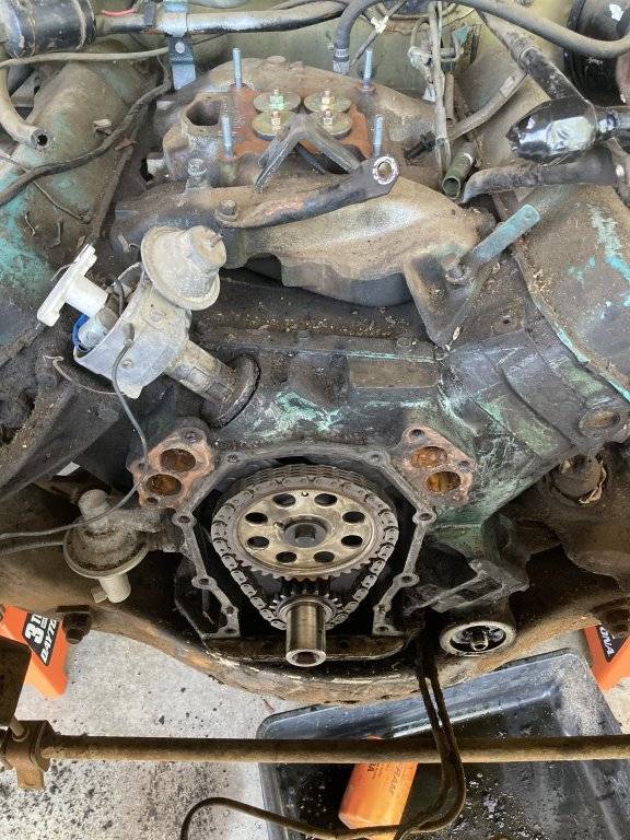

Well Ive got front of engine tore down, it has been apart before, but looks to still have fiber gear. I guess Ill go ahead and pull intake in ck all that I can, dont really want to pull the heads. From what I can see inside, looks pretty clean. I now have my winter project!
Get a good chain for that I like Cloyes myself. Looks in great shape so that means the engine was taken care of. That one is OEM and will skip a tooth eventually.

Ive got a new fuel pump waiting to be installed. Any opinion on Edelbrock double roller gear and chain sets?, im shopping through summit site. I do get alot from them, never had any issues.
Personally Edelbrock is mostly made overseas now Look at Cloyes on Amazon, prob cheaper.
Summit has 3 Im looking at from $25- $122.
Seriously shop around. Summet is good for stuff since they have it but can usually find the same part way cheaper elsewhere. Your just keeping it stock so racing items you really dont need.
What I have done in a car like yours just stock and old. Anything that has rubber like a seal, hose bushing fuel pump etc should be changed since it is prob going to fail if it has not already. NOS say Vac advance does not mean it is good it has a rubber diaphram and can be dry rotted. Just a example. I see things like 50 year old front Mopar oil seals sell. Are you out of your mind trusting that?

As mentioned, Cloyes is probably the best brand to get. I put over 425K on a Cloyes Plus Roller timing chain set on one of my cars. It might be trendy to buy from Summit, nothing the matter with that, but do do some price shopping to ensure you are getting the best price.

Just filled out my Christmas list, have cloyes timing set, mellon oil pump, fel pro gasket set, valley pan gasket and standard ign distributor and hdwr on the way. Still not going to pull the heads at this time. Hopefully this will get her running! Thanks guys for all the ideas and opinions!
