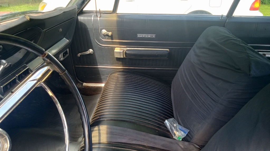

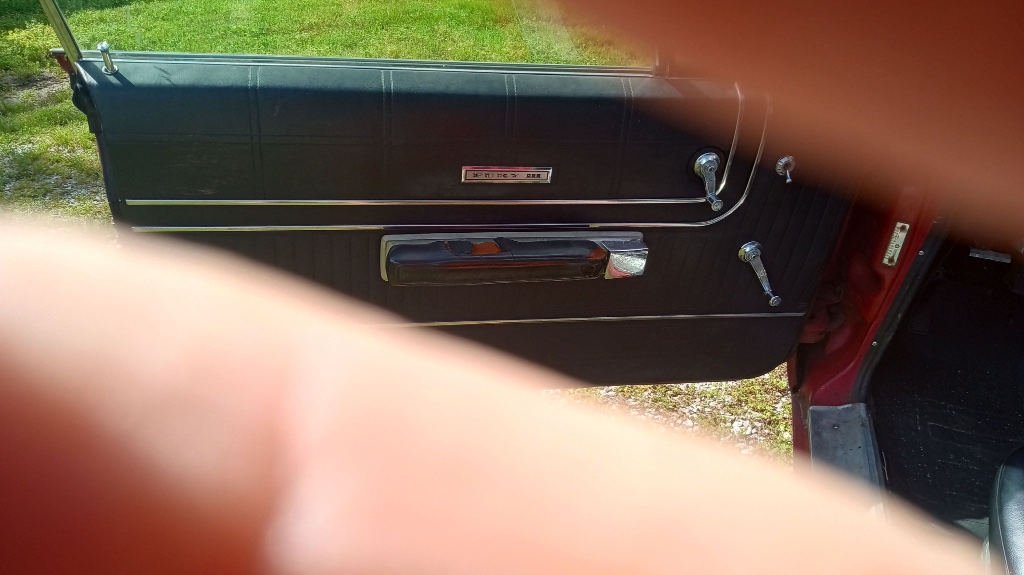

Ive been working on my 1967 Fury 3. Does anyone know if the 13” armrest of the B bodies will work on our C bodies. Does anyone happen to k now if there’s a parts interchangeable book available?

They are pretty much all the same. Just go by length. There are 9 1/2" and 13" long.
Earlier armrests are obviously different, but the same applies.
