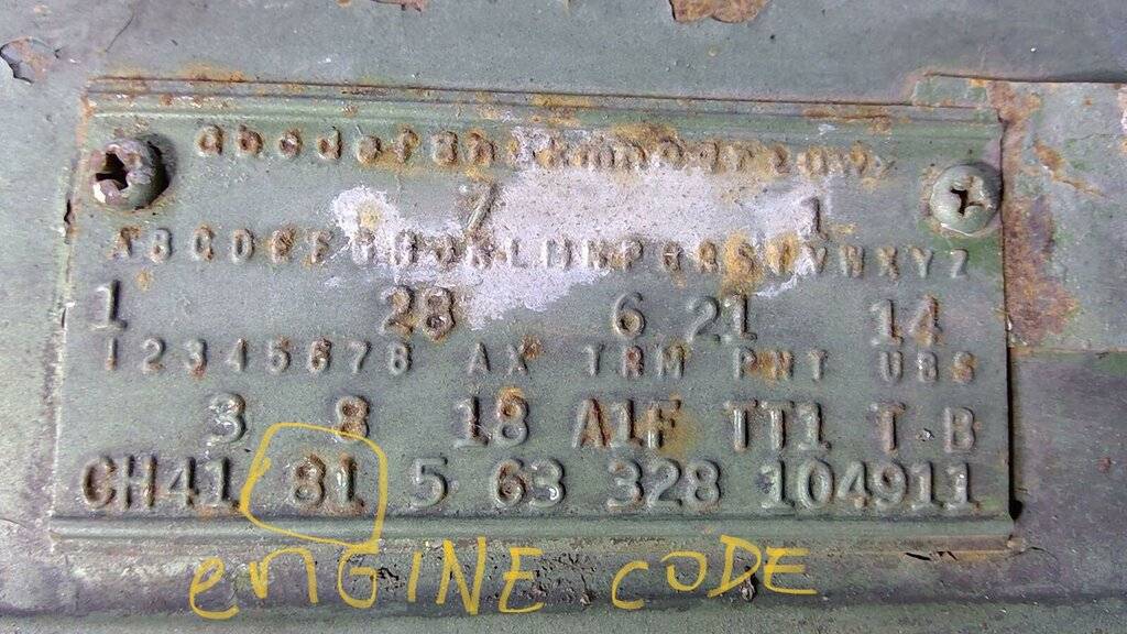

@Camshaft , does the hood open? Read the fender tag codes. That tells the engine also.

my 67 440HP Has the 83 code for TNT, look for that, and the L in fifth digit.
EJ: CE23L77xxxxxx

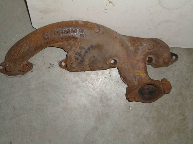

this is the economy newport with the TNT. the manifolds are not the same and do not look the same as a B body HP engine.
