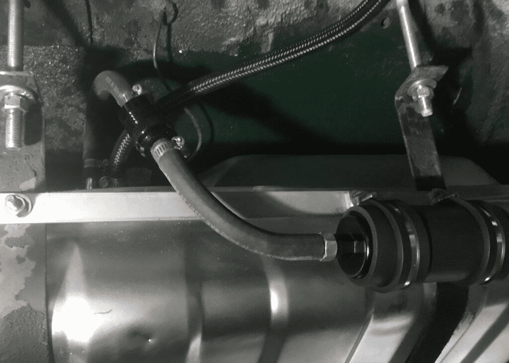

Do you mean the horn for the car under the hood? I was thinking of a in tank pump for my car and would be the best way to go as it keeps the pump cooler and quieter. I didn't have the cash for it at the the time so I placed my pump as close to the tank as possible. They do not pull fuel very well because they are made to push fuel. There is a reason all the OEM's went to in tank pumps, it sure wasn't for easy service. Do you hear the pump run for just a couple seconds when you turn the key to run without cranking it? If so the next time try turning the key on, then off, a couple of times then crank it. That should make sure you have enough pressure before cranking.
