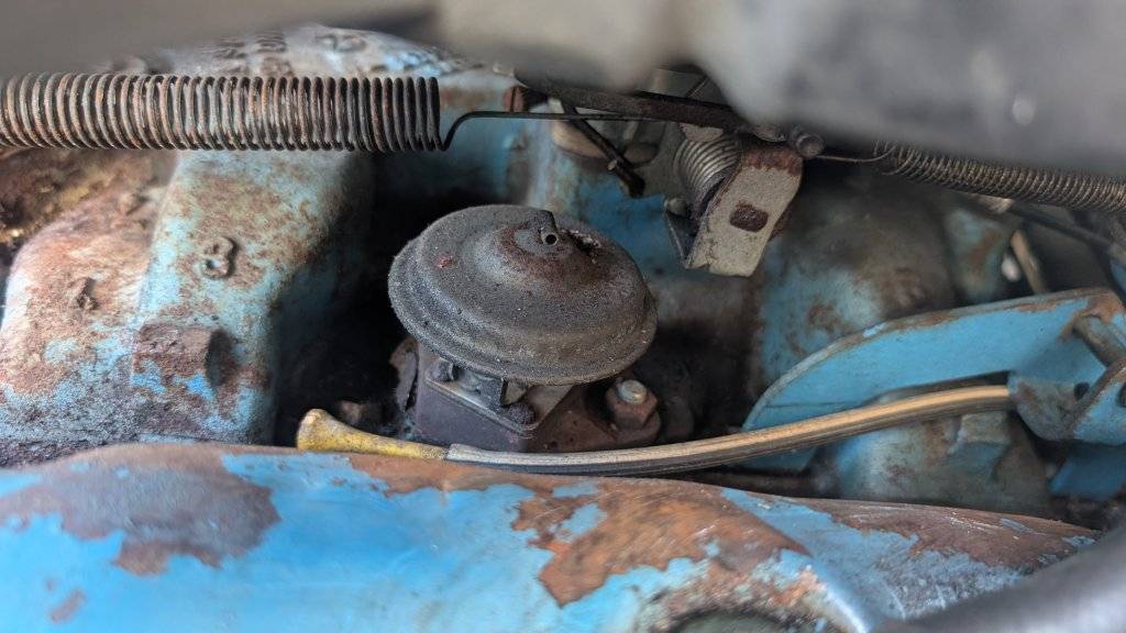

Removed the air cleaner for the first time today and just noticed this, are they supposed to be plugged into one another, and what are they? 360la 1973 Polara
Thank you
The capped off line is to the EGR valve in the photo. A lot of them are unhooked at this point because many of them carboned up and leaked all the time resulting in poor performance.

Is there any benefit to running it aside from environmental benefits? And I'll have to look again but just looking at my picture it seems like I just undo a couple of bolts and slap a new one on much like a thermostat housing? And remove the golf tee and plug it in?
The purpose of the EGR valve was to lower combustion temperatures by introducing some exhaust gasses into the intake manifold. Modern moonshine blend gasoline with 10% ethanol added results in increased carbon build up which blocks the seat on the EGR valve from sealing properly. Yes you can remove the old unit if it is defective and replace it with a new one but you will still have the same carbon problem down the road. There are EGR block off kits online which solves the problem permanently.

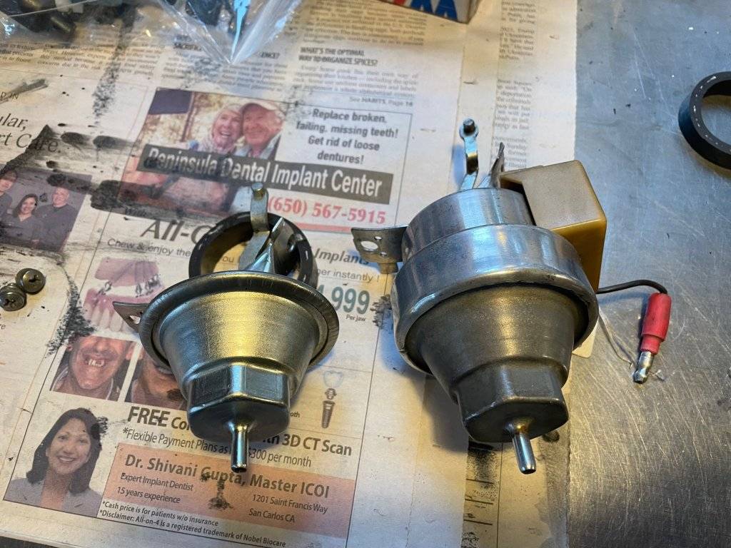

The only emissions equipment I advocate for removal is the very early 70s distributor advance retard (in the form of a solenoid on the vac advance unit), or a vacuum delay valve which replaced this solenoid in '73.
The ball bearing should be the same size or slightly bigger than the vacuum hose-that way you have to use some force to get it into the hose, and the friction will prevent it from moving anywhere. As was pointed out previously, the EGR is a emission control device that reduces NOx. Many people said that they removed it without any problems. NOx emissions cause smog-period (as well as breathing problems for humans). All it takes to prevent it is to drop cylinder temperatures below the thresh-hold of around 2500-3500 degrees. The car manufacturers found they could get back some of the performance loss by adding additional ignition timing (leanburn in the mid '70s). Too much causes ping. The reality is that valve reduced an emission with very little effect on drive-ability, unless it wasn't working correctly to begin with. Sometimes the valve would stick open, which would cause stalling (EGR should only work off idle). Does this car have a vacuum amplifier that is the vacuum circuit before the EGR? Chrysler did have a lot of problems with that-causing the valve to stay open at idle.
The car runs great with it disconnected, great oomph and pedal response and no pinging so I will likely not replace it or attempt to get a new EGR valve on there. Reading the explanations and various experiences with regards to this was very informative. It's likely stuck open or closed and when plugged in causing an issue and the fix was to plug it, OR, someone got over-zealous and thought they were increasing horsepower by unplugging it. At this stage in the game as the car runs well I don't think I care to plug it in especially since it sounds like there's a possibly this equipment could cause it to run lean.
