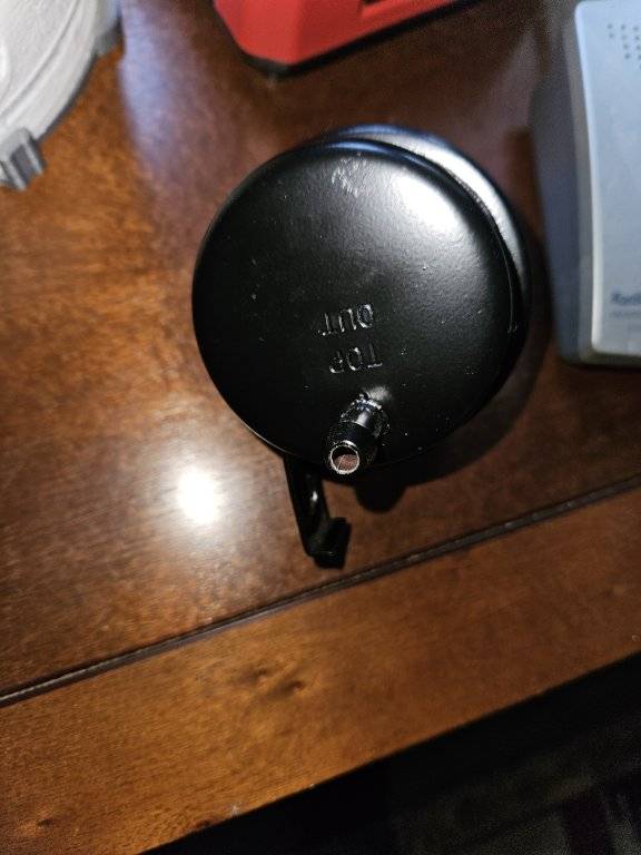

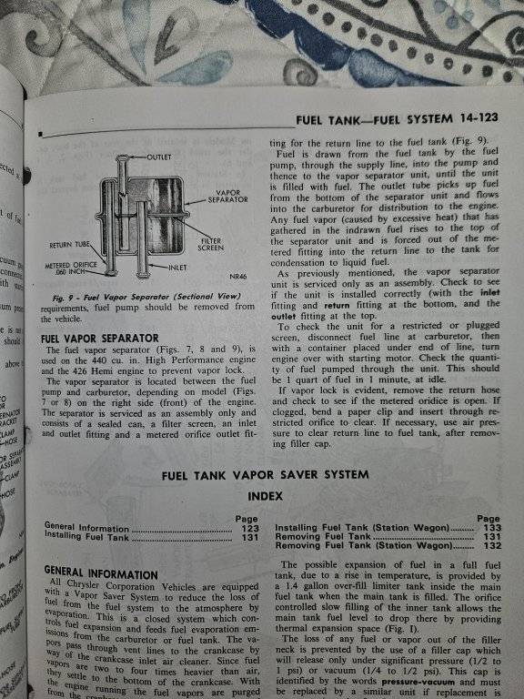

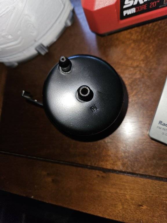

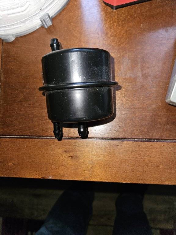

Vapor lock is a common problem with our chryslers. Chryslers solution was a special fuel filter. See pics
From what I've seen, the Vapor Separator was not used on everything, just particular performance models over 1-2 model years.

The elevation-location of a vapor separator would seem to need to be in a particular location to work, it seems. It will also require a return line to the fuel tank. Like the GM fuel pumps, which had the "return line" in certain applications, there probably is a drilled orifice in the return line nipple's pipe somewhere.

When i drove the chrysler up from Texas. to Indiana 20 yrs ago (93 octane no ethenol) it had serious vapor lock issues. I would leave it running when filling up just to avoid the starting problems. At the time it did not have this special filter. It is a 440 TNT.
The Vapor Separator is not a filter. Just internal baffling to "separate vapors" in the fuel line.

I can think of no better way to burn up a starter motor than by vapor lock. Hopefully when i install this filter it will solve the problem. If not, will try other methods.

Another check is where your initial timing is set. You will find the car starts faster when the timing is where the engine wants it and not what the book says. And by 1976 vapour return fuel filters were used on all the Chryslers. Wix 33040
