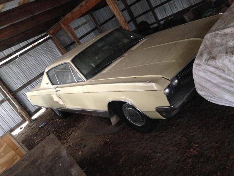

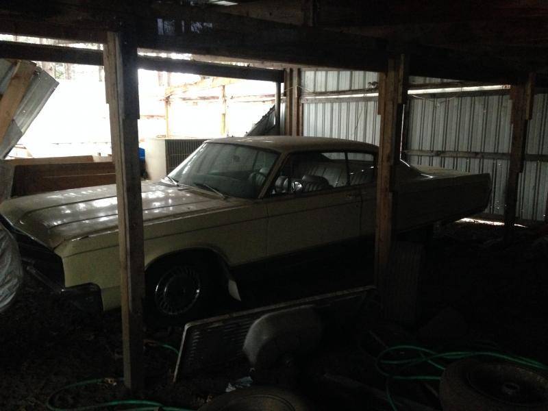

Here are some pics. I have not gotten it out of the barn yet. IMG_0724.jpgIMG_0727.jpg

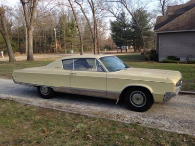

Stock original OEM wheels.

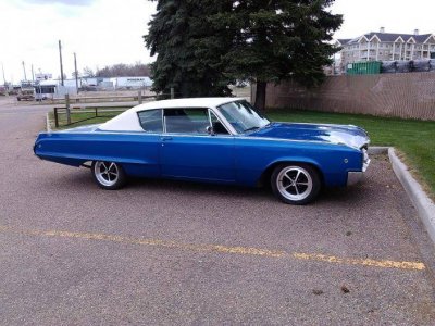

Here is my '68 Polara that I just put Year One magnums on. 17x8's on the front w/245/45's and 4.5" backspacing. 17x9's on the back w/275/40's and 5.125" backspacing. I spent a lot of time looking at what others had done as well and trying to figure out what would work. With this setup the rear has about an inch of room between the tire and leaf spring so you couldn't go much wider. The front still has a decent amount of room. I had tried finding tires with more sidewall. I was hoping to go with 55 series on the front and 50 series on the back. Nitto makes some but the tire shop I went with couldn't find any and I was wanting to get it out on the road.IMG_20140509_163931.jpg
