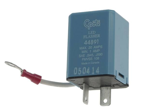

The other things about using LEDs for signal lights which flash is that you'll need an electronic flasher (to replace the current "thermal load" flasher) and/or an add-in to let the flasher see the same load as it'd see with the former bulbs, so the flasher will work decently well.

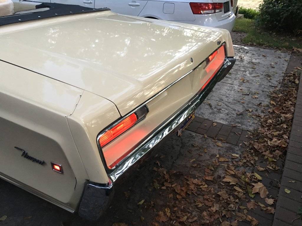

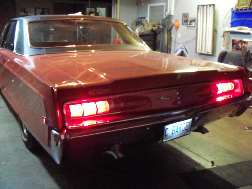

I use bulbs from these guys..
LED Brake Light, Turn Light and Tail Light Bulbs | LED Car Light Bulbs | Super Bright LEDs
Get the 360 barrel bulbs,they light up the whole housing.
When running LED in your C Make sure you use this:
You will have to swap the polarity of the black/red wires to the flasher plug to make them work.

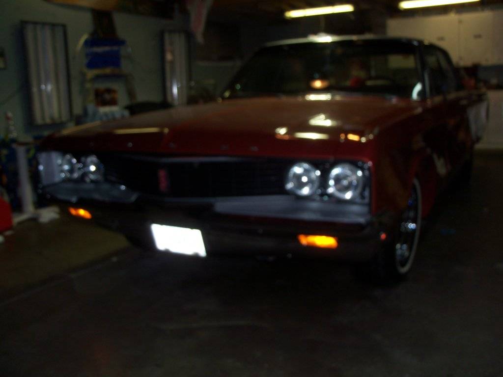

I just did a full LED conversion on my dad‘s 95 F150, I know it’s not a C body, but I thought I’d share my experience. I did the entire truck from tag light to headlights and all interior light.. the difference is Amazing!! Just say’en..
