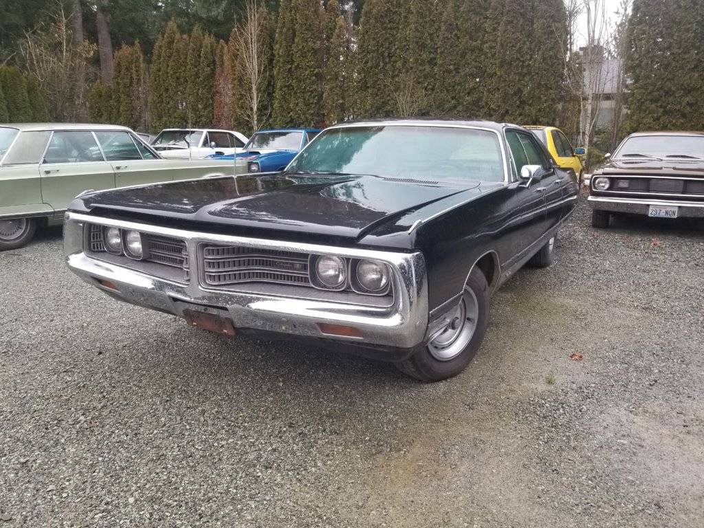

Thanks for the replies. The green 300 will be rescued from where it sits, I will get some better photos when I pick it up and give it a quick bath. When I drove it in 2014 it ran good, shifted fine and stopped well. The exhaust is kind of ratty on it with a couple leaks but nothing too bad. I can't remember if the Autotemp worked or not. I wouldn't even attempt to try and drive it now, when I looked at it I was pulling chunks of the stub frame off and it was packed with rocks and sand.
The car has some good points, but there is a lot of rust in the seams of the body and so on. If you look in between the trunk lid and the rear bumper on the passenger side you can see it. The trunk isn't terrible, and could be patched but it would be a big job. Then the frame rails and the 1/4 panels, fenders, wheel houses, etc. I won't part the car out before offering up here first, will keep this updated once a deal is reached. For the parts I offered up in trade, I'm into the car for a good amount of money already. I just didn't want to see it get any worse.
The Winchester gray car is super cool and really in decent shape overall. The stub on that could be patched, but I'm looking for a donor one before trying that. I'll spend a weekend on it trying to bring the paint back and cleaning up the interior as best as I can. It's a very straight and original car. The doors close nice, no leaks, and everything works as it should. I bought it mostly for the colour as its one of my favorite Mopar colours in 1971. After getting it running and doing a quick spin around the block, I've taken a liking to it so it might be one I keep. Again, if I do decide to sell it I will offer it up here first.
I do happen to have a donor car, but I feel bad about ripping it apart as its a really nice running and driving car.
Agreed! Can you please post more info about / pics of that '72 New Yorker (Brougham, if I see correctly) -- especially the interior and rear? The fender tag would be great, too. I might be interested in that car if it's for sale, since you are in BC.
