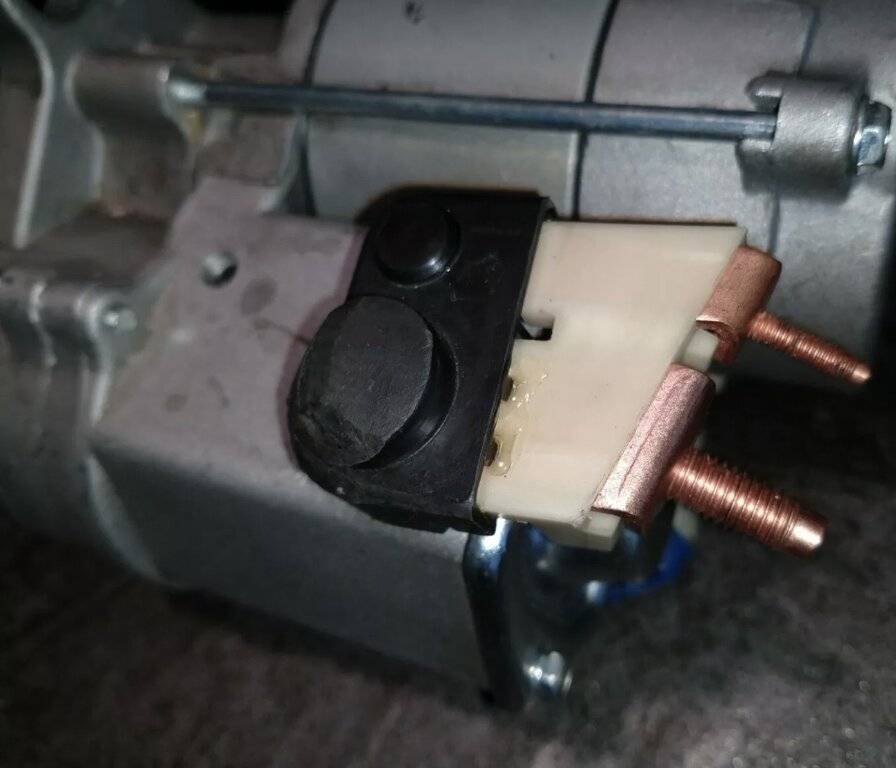

Yes, the Moparts post said that about the MP starter, regular replacement starters fit just fine, it's the wires that are at issue.

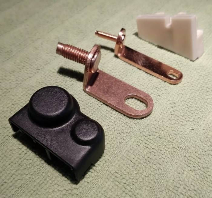

I have purchased the mini-starter (eBay link above) for Medina. Here are pics from the listing for records: the battery cable terminal adapter to which Wyatt and Steve refer is shown in the last photo (it can also be bought separately).

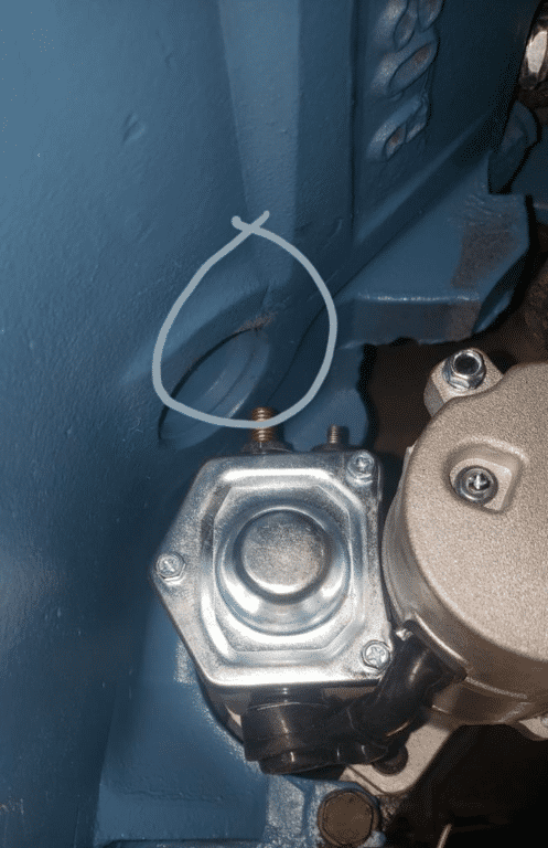

Turns out that I am blind, as I did not see that the adapter in the one I ordered was not the right one. As one can see in the photo below, taken by @71Polara383, it leads to rubbing against the block ("see where something has rubbed on the paint? That's where the terminals included with the mini hit the engine"):
So I bought the adapter recommended above by @3175375, from eBay. Installation should be complete by this weekend at the latest.
