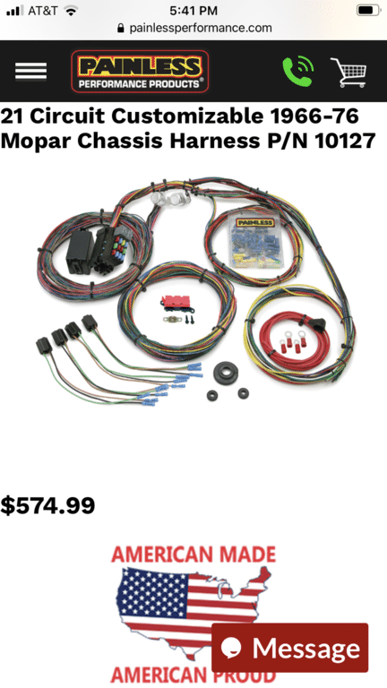

Looking to update the factory wiring in my 68 Imperial. Has anyone used this or any other Painless wiring harness, on their Imperial?
In my opinion, unless your original wiring has suffered a catrastrophic fire, you are far better off financially and headache-wise to refurbish your harness and do the bulkhead bypass and amp gauge improvements.
That's not an update and from everything I've ever seen, the name "Painless" is incorrect.
It's basically taking a GM style harness and trying to make it fit. Waste of time and money.
IF you were building a street rod from scratch, the Painless kits might be a good option. Replacing a factory harness with a Painless kit, that's ONE BIG PROJECT that might not get finished.
When Painless was started, it was by two street rodders who discovered a niche market in wiring harnesses. Their then-claim to fame was that they used Delco/Packard wire and OEM-level connectors, which was usually better than what other harness people used back then. FWIW
Do the bulkhead/ammeter gauge bypass and be done with it.

I’ve used the painless kit, no it isn’t painless lol. It’s very time consuming, like all wiring projects, but it’s quality stuff and the instructions are very helpful for wiring systems together from scratch like starting and ignition. Good kit when fixing a car with a wiring system that’s in shambles.

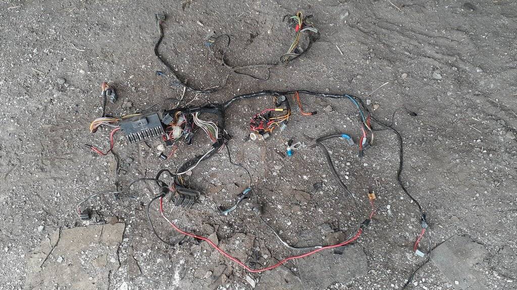

I had a closer look and not as complex as I remembered. But a whole bunch of connectors to the various imperial doo dads
This one has a butt connector and some other repairs and the usual melting at the bulkhead. But nothing that couldn't easily be fixed
