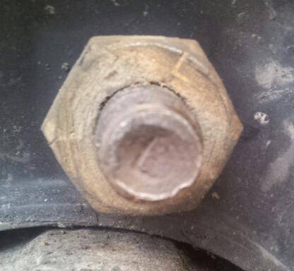

As mentioned, in stock form, your car should have left hand studs on the drivers side. However, many cars have had lugs replaced by now to right hand thread.
Left hand lugs are stamped...look for an "L" to be sure.
Not always. Those on my '62 were marked; those on my '70 were not.
