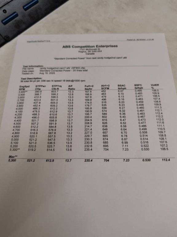

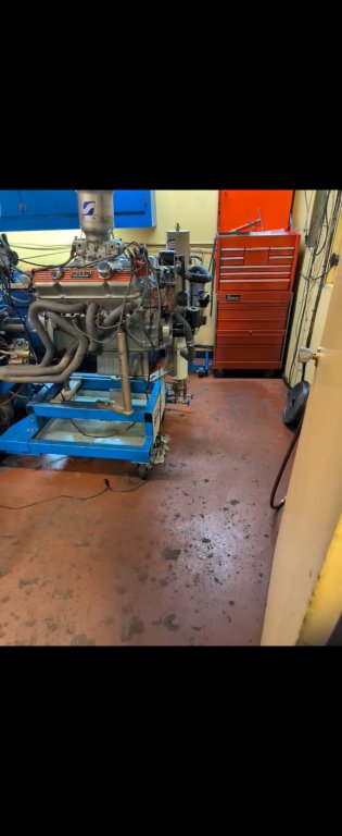

Hi, just had my stroker 383 dynoed and it made 521 hp and 612 ft/lbs of torque. should pep up the 66 fury 3.

What rpm for peak torque and HP or a Dyno graph better yet?
Very nice numbers! Football field torque!!
A little lean there in the middle but great numbers. Won't really need much stall if any and will pull 3.23 gears all day long.
