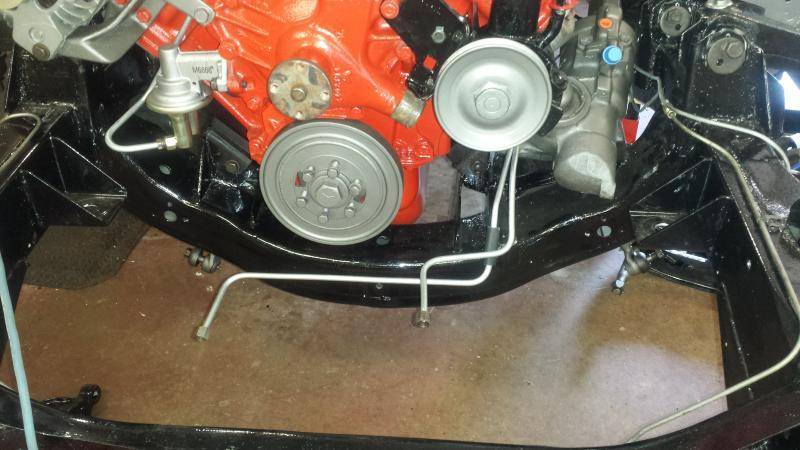

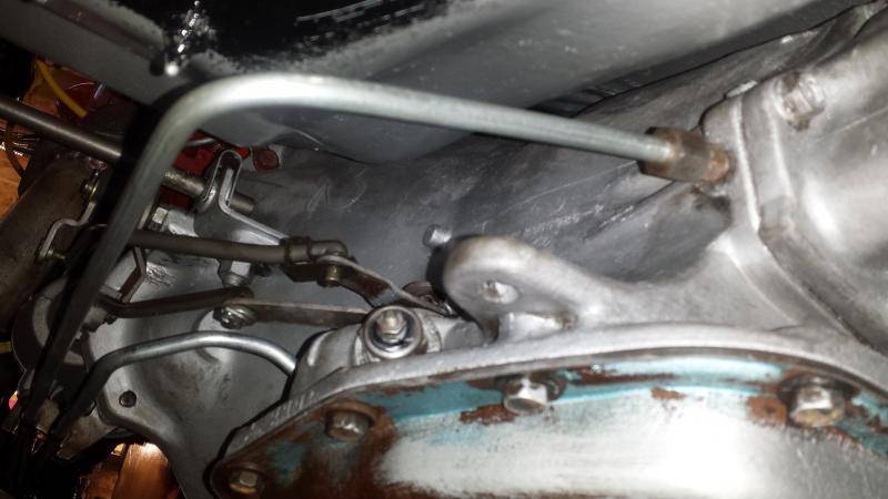

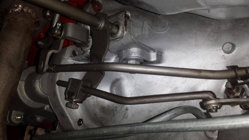

With all the work I have been doing to the Polara, I decided to bend up a pair of new lines.
The old ones were functional but looked like hell.
(see the 1st photo here..)
Plus with the front clip off still it was much easier to do now and near impossible once it is all back together.

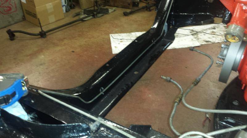

I laid the old lines out onto a table and clamped them down so i could reference the lines as I bent the new ones.
Again the wonderful thing about these old cars is that we have so much area to play in that I could make nice straight 45' & 90' bends without worrying if I had strayed a bit.
