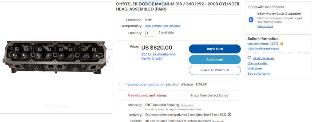

Looks like they are still in business.
Home - EQ Cores & Recycling
Looks like all sales are thru ebay.
Some of their listings show China as country of origin.
