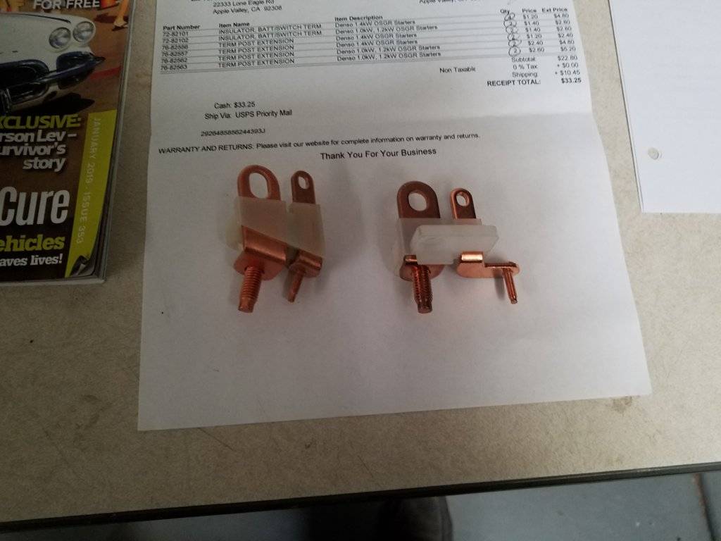

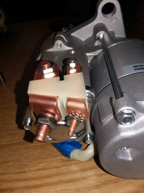

The later starters have a molded plug in for the starter terminal. The early ones have 2 studs and can use the diffrettnt adapters to move the location of the terminals if needed. The one in the pic is a 90 D-100 360 CID . There is a thread on this if you do search. Thanks to that person for that info.:thankyou:Pic of where I got the adapters from.

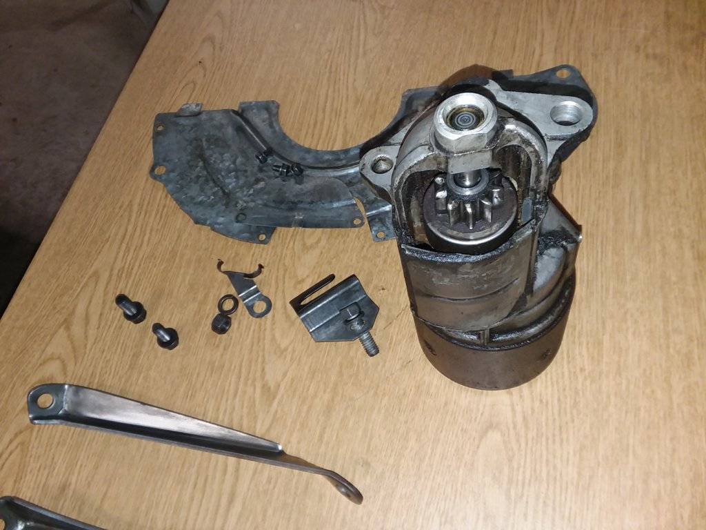

My original type starter works fine all summer but acts up in cold weather. Feels and sounds like the reluctor gear is not fully engaging. I would imagine what ever gunk or grease inside gets stiff sitting in the cold. If I pull it to clean I’ll probably just install these new mini-starters.

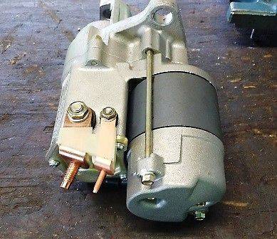

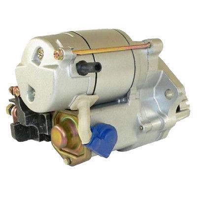

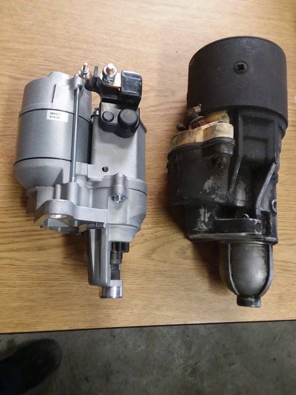

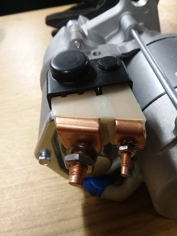

Starter 410-52033 powerpartspros1 ebay, 1994-95 360 Denso-type new mini-starter
Adapter, badvert65 ebay

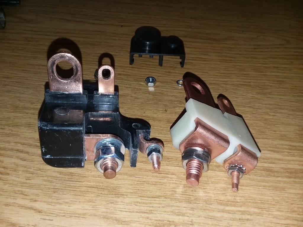

Old & new (as shipped), wire terminals on opposite sides
Popped off black plastic cover and removed adapter block installed on new starter, 2 nuts
New adapter on right

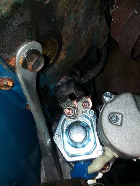

New adapter mounted
Black stud cover still fits over 2 studs

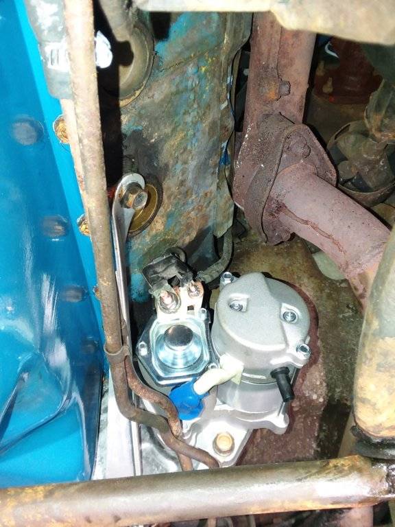

Although wires mount on opposite sides, about same length from bell housing
New starter, easy to mount, unlike old starter, able to get torque wrench on both bolts

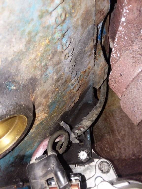

Wires mounted
Wire routing
From below
Result: Fury 360 Edelbrock 1406 starts instantly. Extremely impressed. Starts like a fuel injected car.
Shout out and thanks to @barnfind for modern starter idea and pointing me to the adapter along with @Dan Scully and @saforwardlook.
