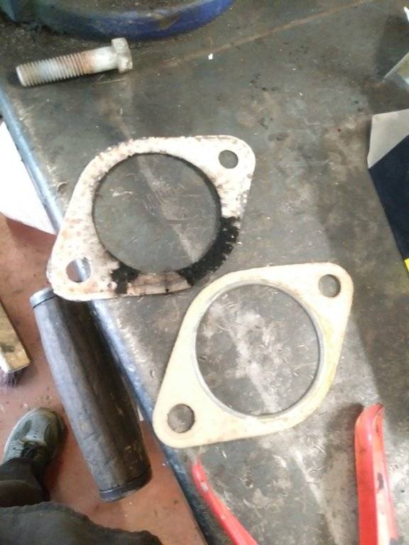

Get a good quality gasket with a metal ring in it.
The el cheapo gaskets that came with the TTi system burned out..
You can see the difference between the two..

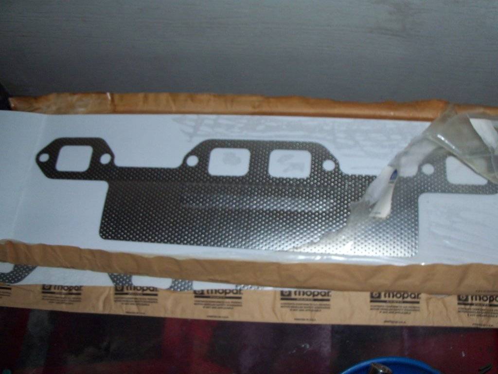

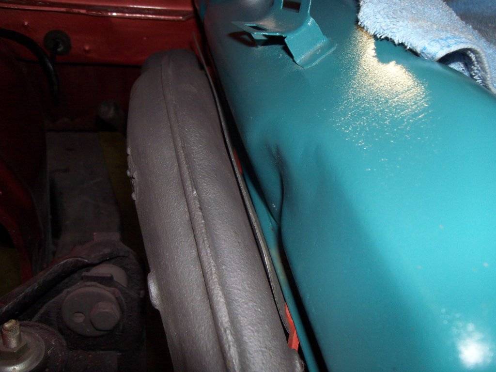

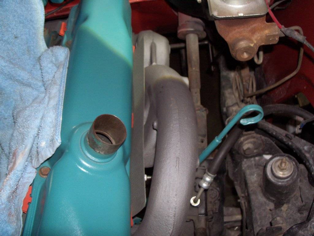

Regarding the manifold to head....yes usually no gasket.
However,on my Newport Custom I used the manifold gaskets that doubled as heat shields between the HP logs and valve covers..
3 years and well over 10,000 highway miles,the valve covers and gaskets are not yet cooked,LOL!
