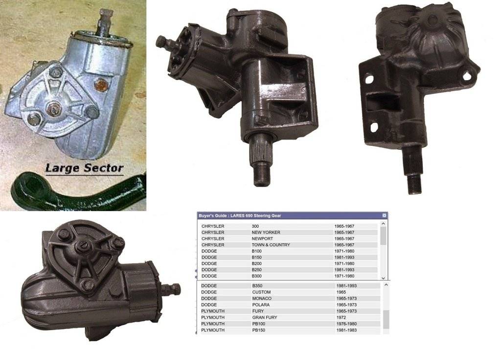

Hey Guys,
I am looking for a good large sector manual steering box to fit my 1970 Plymouth Fury.Would like a good one that doesn't need rebuilding.It's for a top secret project.:steering:I will pay shipping to 04915 in Maine.I have Paypal. The Lares 690 reman is unavailable anywhere.
Many Thanks,
Mark
I have one from a 65 or 66 but can't guarantee it doesn't need a rebuild. Pm me if you want
I found a few listings for the correct manual box on car-part, but when I called , every single junkyard no longer had the vehicle.Any ideas guys?
I guess my next question is are all the other front end steering parts the same or do I order different stuff?
Only change needed is manual steering pitman arm. All other front end components are the same.
I believe this is the same unit that was used on the 70s B-Series Dodge vans
Alan
Yes, and the worm gear assembly is the same as the other manual boxes in the A, B, and E bodies. That's usually the weak point in those boxes. That worm gear assembly is available in 3 different ratios for your specific needs/wants.
So I can change the worm gear only and get a quicker ratio? Where are these parts available?
