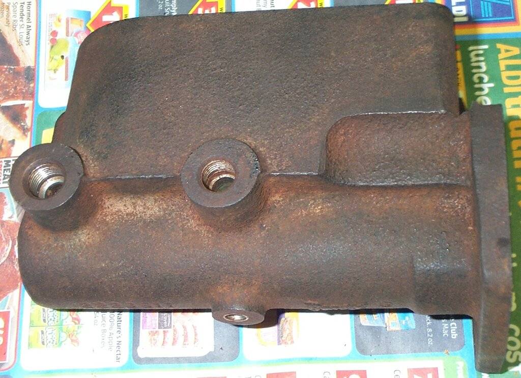

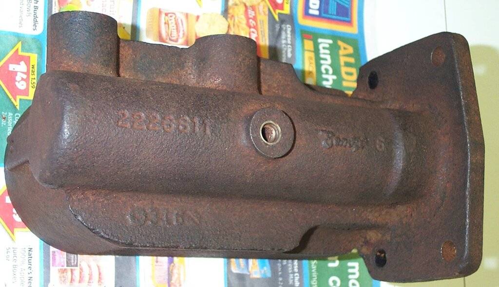

They were very haphazardly painted semigloss black. Pics below show my original 1967 M/C prior to having it sleeved, you can see the remnants of the black paint. Last pic shows it rebuilt with a NOS cover. Its incorrect in that I painted it in chem-resistant cast iron. Booster shown is a '68 but is correct color. The '69 uses a different M/C & the one shown in the above pic is aftermarket.
I suspect that the boosters were supplied to Chrysler with the master cylinder already installed and that the painted units were likely painted as a complete assembly, which would explain the painted cover and hasp. The plated boosters likely had bare master cylinders with a plated cover.

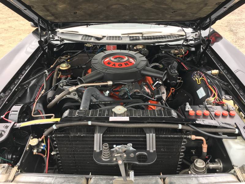

Here is a 1969 picture of a 1969 CHP Polara,
and a picture of a somewhat original 68 CHP Polara taken a few years ago.
Alan

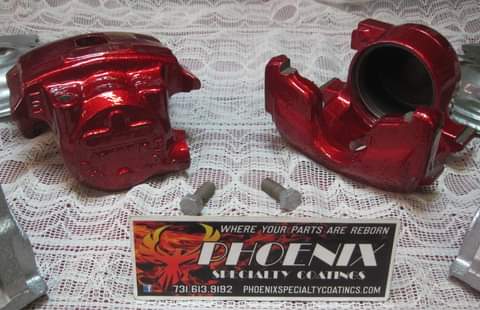

Cast iron coats beautifully (all I have on my phone is a pair of flashy custom candy coated calipers but you get the idea).
If the job is well done it will last a lifetime. Be sure to clean any spills on the sides and bottom of your master cylinder promptly if you aren't using Dot 5; it won't take it down to bare metal but could dull a shiny finish a bit if left to soak in. Of course all threads should be plugged and the interior portion should stay bare.
