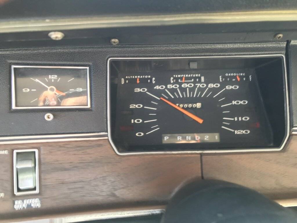

    Medina passed 79k miles around noon today while on the 2020 CATL drive. Thanks to @71Polara383 for all the work and making her a smooth ride!

    Not only is the odometer worth noting, so is the temperature guage showing it to be exactly where it should be. Congratulations!

    Thank you! Today was a nice fall day, with afternoon temps in the mid-70s: the gauge barely budged even when @sixpkrt and I kept up with the fast traffic on the highway back from the CATL. I put close to 400 miles on Medina this Sunday, she performed like a champ: I think she’s ready for even bigger trips next spring :steering:
