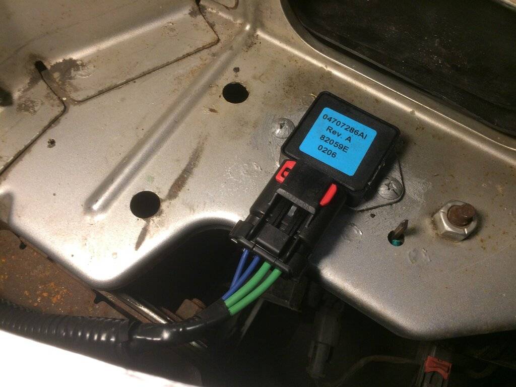

On a trip down to my friend's house the other day the check engine light came on and the electric fans stopped working. Of course it was one of the warmest and most humid days we have had yet this year and I wasn't able to run the A/C without the fans operating. Not too surprising, I had a code for the fan circuit. I had already installed a brand new, genuine Chrysler fan relay, so I tried plugging in the original relay and the problem didn't go away. Wiggled the wiring to the relay and the fans came on. Closer inspection of the connector revealed that the second pin from the left was installed upside down when the harness was made. Flipped the pin over and all is well again.

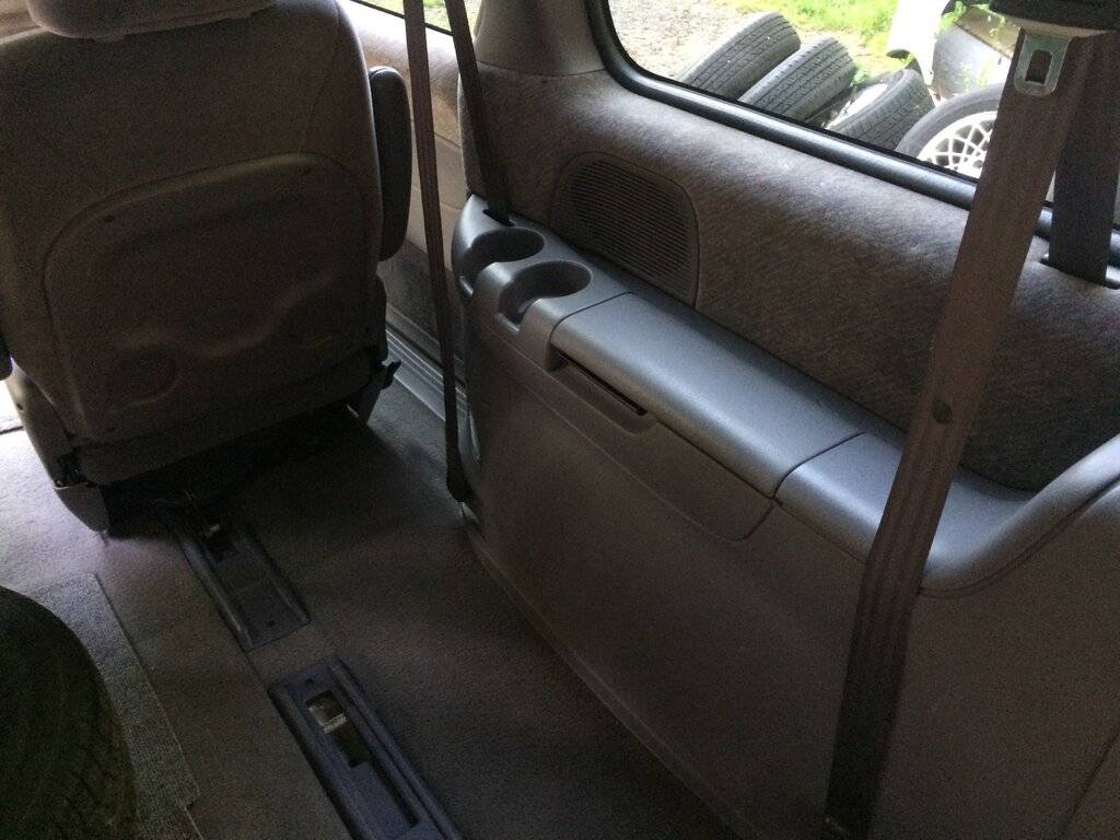

One down side to the nice rear interior panels that I got at the junkyard was that someone broke off both storage compartment doors. I bought some cheap hinges and melted them onto the covers. I could have done a cleaner job if I did it when the panels were off, but it came out ok.

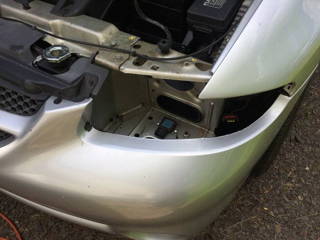

The van was my ride to Carlisle this year, though I didn't make the trip without problems. I got stuck in a traffic jam on I-476, and while sitting in traffic on came the check engine light while the temp gauge climbed up to the top. No electric fans again. After making my way to the shoulder, I took out my tool kit and removed the left headlamp for access to the fan relay. Jiggled the connector and on came the fans. So much for the upside down pin theory. Luckily, the fans worked fine for the rest of the trip.

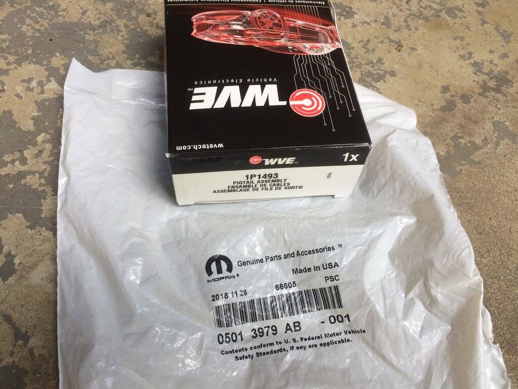

A genuine Chrysler fan connector goes for around $45. Photo on Rock Auto for this one looked just like the Mopar photo.. and it turned out to be the genuine article, for a much more reasonable $14.

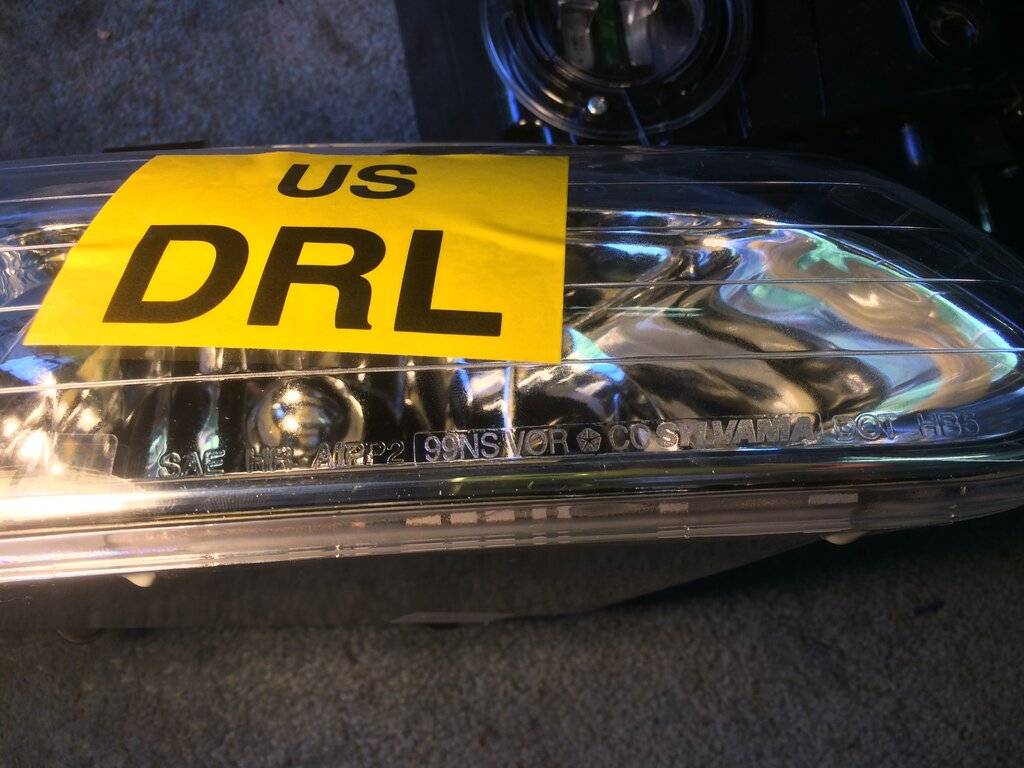

The plastic holding the mounting studs on my Chinese headlamp disintegrated when I took it out, which was very disappointing, since they had the best low beam pattern of any lights I've ever had. I tried epoxy, but it didn't work.
Ebay to the rescue again. Got a set of Mopar lamps for less than 100 bucks.
