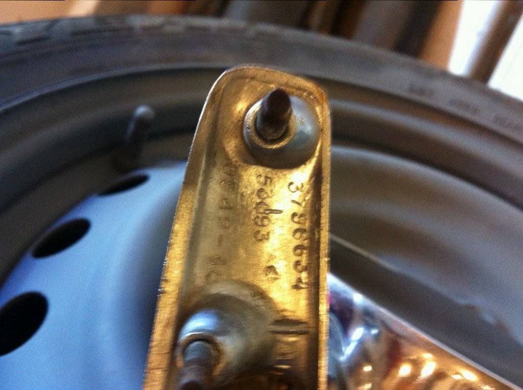

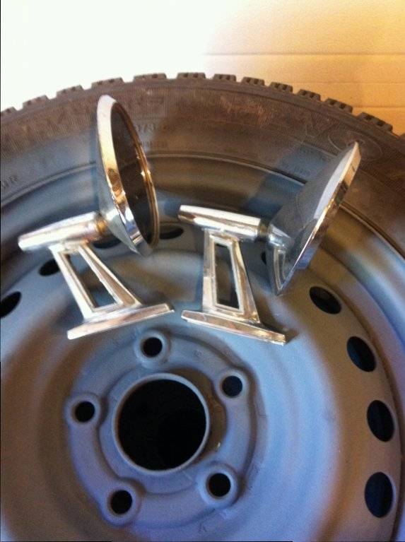

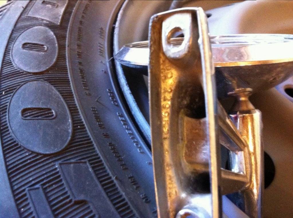

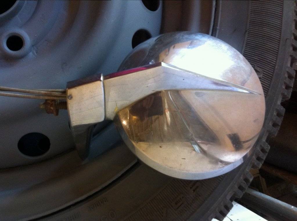

can anyone tell me what years these mirrors will fit
Two look like fender mount for Imperials. The last looks like c body 65-68. (I think)
the first ones are early like up to 64 or 65 for non remote adjust type for a and b bobies , now the last in your series starts being used in 65 for the remote adjust mirror option on a , b , c bodies . my 64 300 k has a similar looking fender mount mirrors but there remote adjust type .
If I remember correctly, the first pair were used on many full size forward look DPCD and Imperials from around 58 to 64. Usually mounted on the fender just in front of the A pillar.
Sorry for the "disagree," but I have one of those at home and they're quite different.
The last picture looks to be a right hand mirror for a 65-68 c body. They also fit several b bodies and a bodies as well.
First two are 1962-65 A & B body and should have a pentastar on them. They have been reproduced but sans the pentastar.
Those were also used on C-bodies in 1965.
The remote mirror in the 4th picture, I'm pretty sure, was used on '65 thru '71 A-bodies, '65 thru '70 B-bodies, and '65 thru '68 C-bodies. It may be correct for newer A+B-bodies also.
