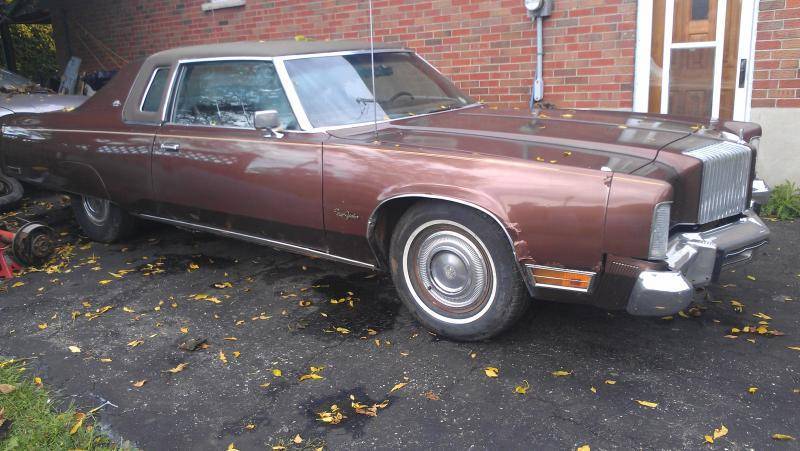

Now before you all blast me for decapitating a perfectly good NYer, its not. The last owner had it for 10 years and drove it here and there, he had 10+ mopars kicking around. Before that it sat for years in a field for years, so the body is ruff along the bottom and the floors are shot. My plan was to strip and scrap it. Its been sitting in my yard since, its starting to grow on me..

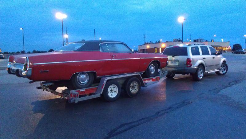

There's the workhorse pulling the fury home. Truck has 359,000kms on her and has never let me down!

Welcome aboard. You seem to be a creative thinker. Couldn't see your pics for some reason...
I have no idea why, I followed the instructions in tallhair's SIG.. I hit preview and the showed up but once I posted it just showed as link.. If I click the they open the pic for me.. Can anyone help?
That worked I think...

Also was anyone able to see those pics?
