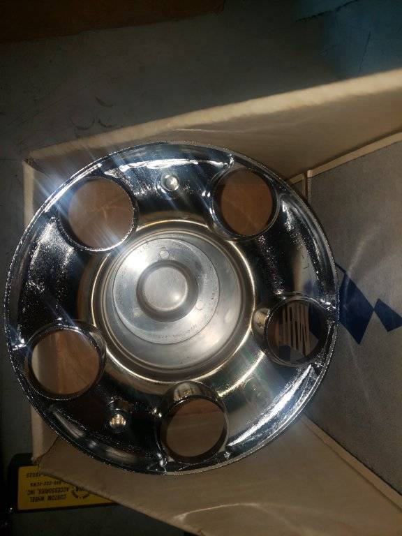

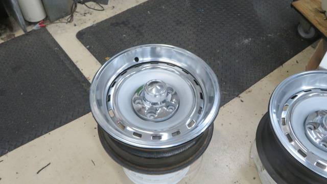

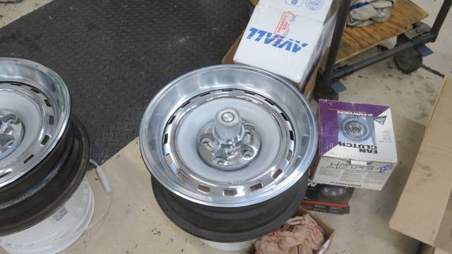

Good Day All
Just received the Road Wheels from 'C Body Boat'.

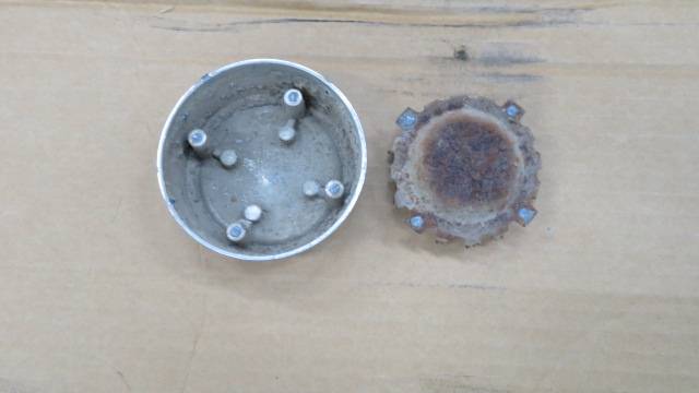

The wheels look great with one small casualty; one of the center caps was damaged in shipment. Not a huge deal, I believe some JB weld would repair it nicely.
I have a collection of center caps from vehicles long gone. I found some 'Magnum' center caps and with a little modification to the retainer was able to insert it into the Road Wheel.
Here are a couple of pics; Opinions Welcomed:
Original
Modified:
Damaged Center Cap:

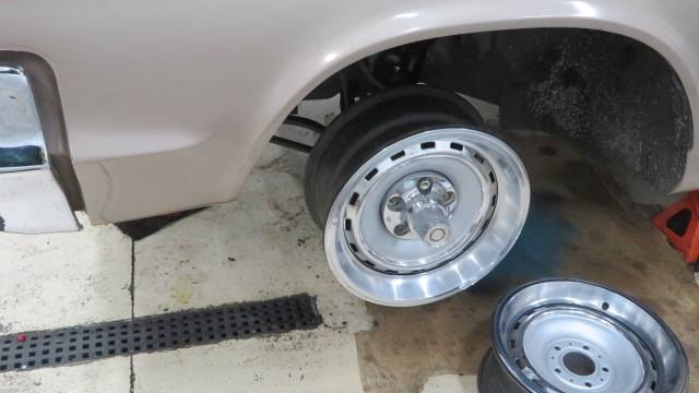

Mounted on the 'Barge' (65 Newport)
Good solution. There’s an AMC center cap that looks very similar to the original, except it has grooves at the end.
Well, they're both wrong for the car, so it looks great!
I’ve repaired a couple of caps after the retainers broke off like that .I did it by drilling a hole in each of the 4 cast mounts that originally held the retainer and used a small machine screws to secure the retainer to the cap in its original position. The screws threaded themselves nicely into the softer pot metal mounts of the cap . I’ve had no issues with them since.

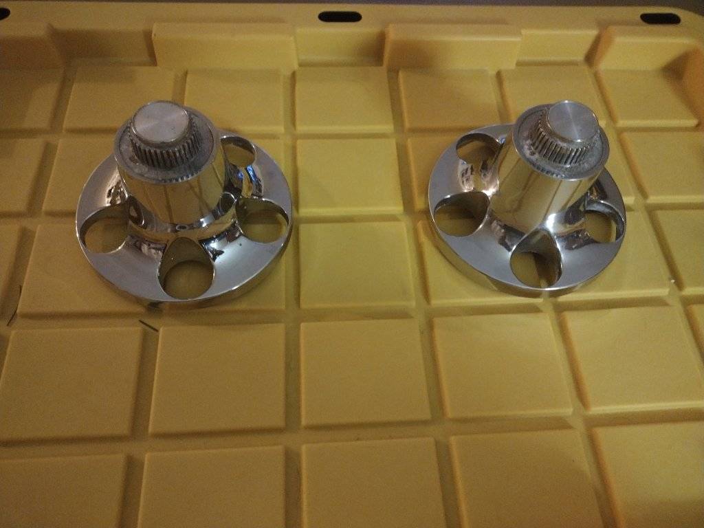

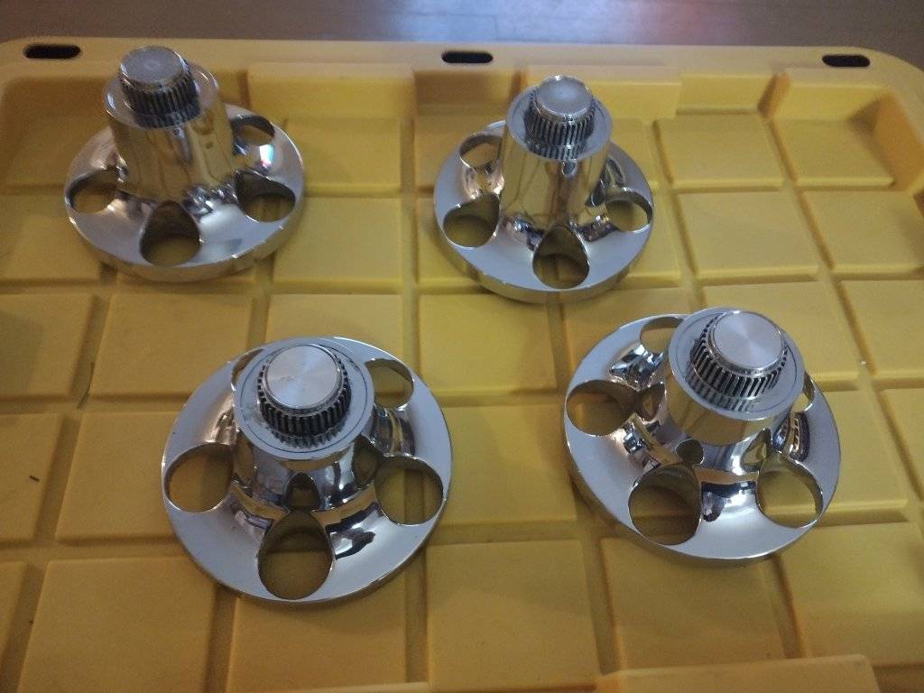

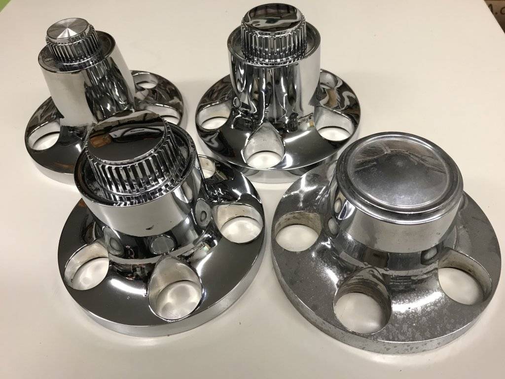

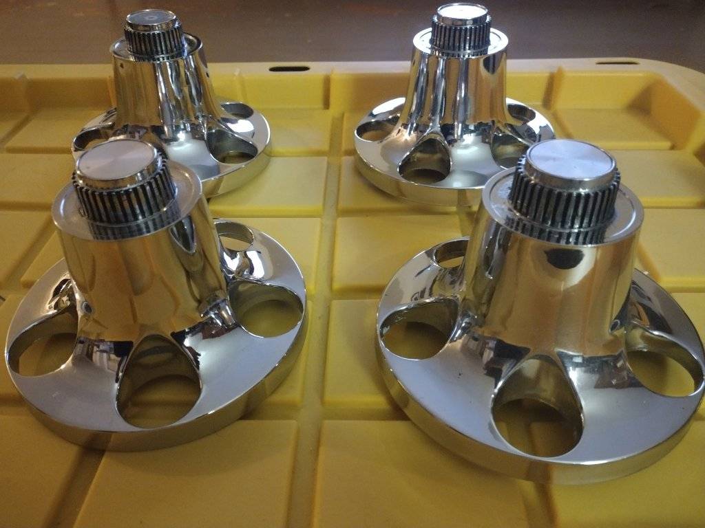

Omni if your interested I have a set (4) of the AMC Tornado caps that I polished& repainted the black spines that I was going to put on the Chrome Road Wheels for my wagon .I kept the Magnum 500's & sold the road wheels.
I also have 2 that need refreshed.Looking to get $150.00 for all 6.

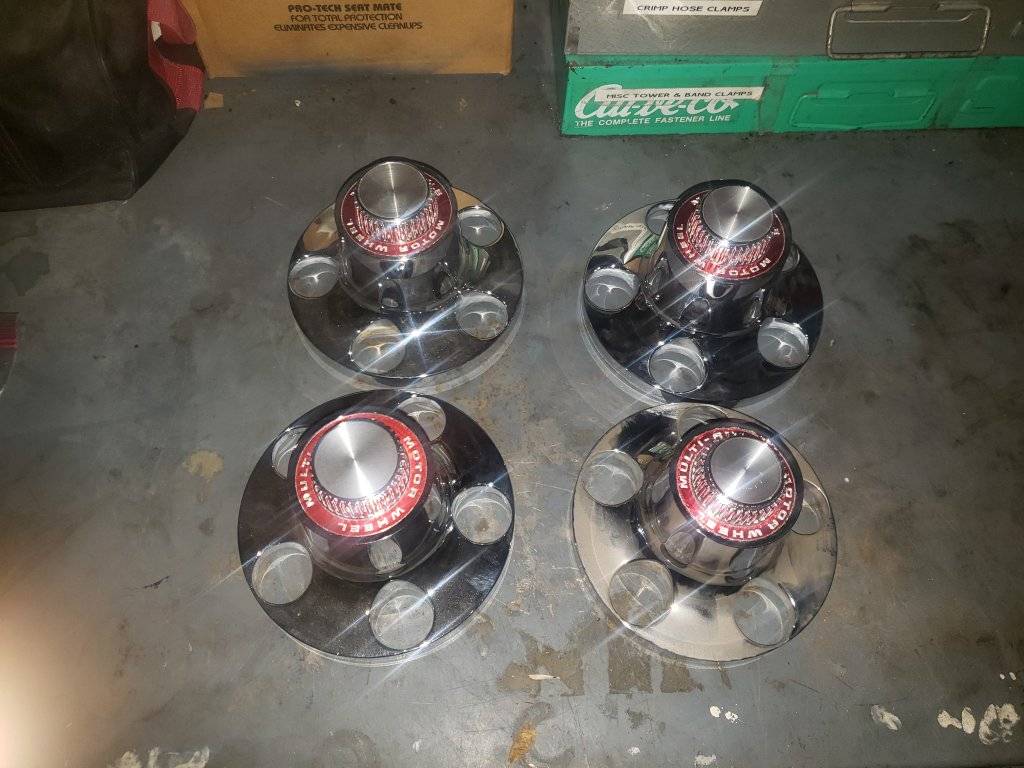

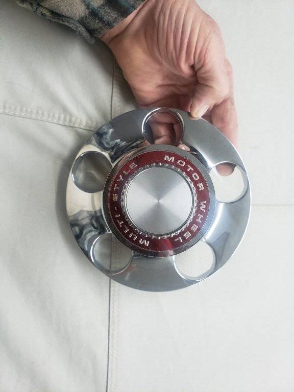

I have these aftermarket style for sale $100 for the set + shipping. If any interest in this style. Thanks
I painted the splines using Hobby Fine Brushes sold in a package of 10 @ Hobby Lobby they are small plastic handle with sponge tips. They worked very good i think they were $4.99 a bag.
FWIW, the AMC caps are a slightly larger diameter (about 1/8") at the base than the Roadie caps.
A Road Wheel cap will mount to a standard steel wheel, but the AMC cap won't seat fully, it would need some spacers.
I had them mounted to the wheels and drove car couple hundred miles with no problem's. Buyer did not want them wanted the stock caps instead.
