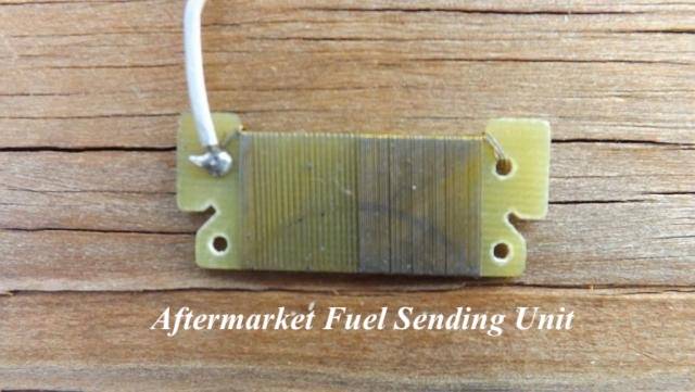

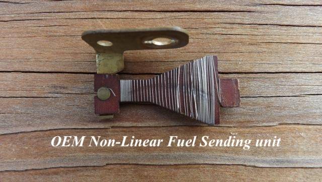

I could almost 100% guarantee it's the tank unit that is causing the issue. Replacements now days are rarely accurate. In fact yours may be a replacement. As long as it's consistent, you can head to the gas pump when it get's so far down before it runs out. Otherwise it might be time to get yours rebuilt.
