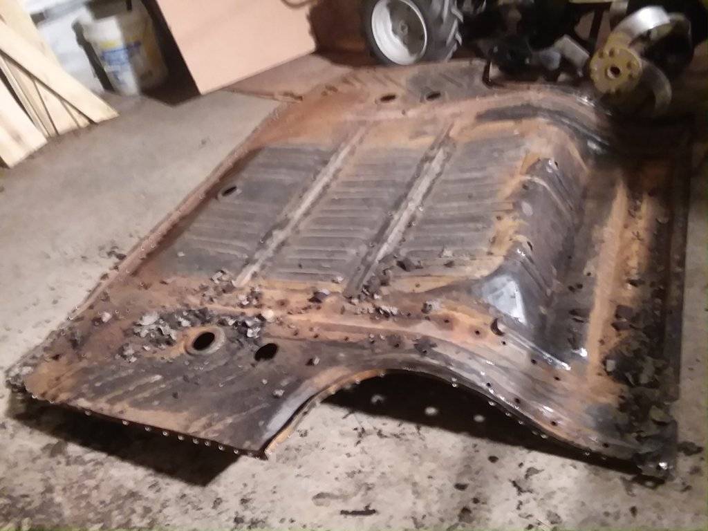

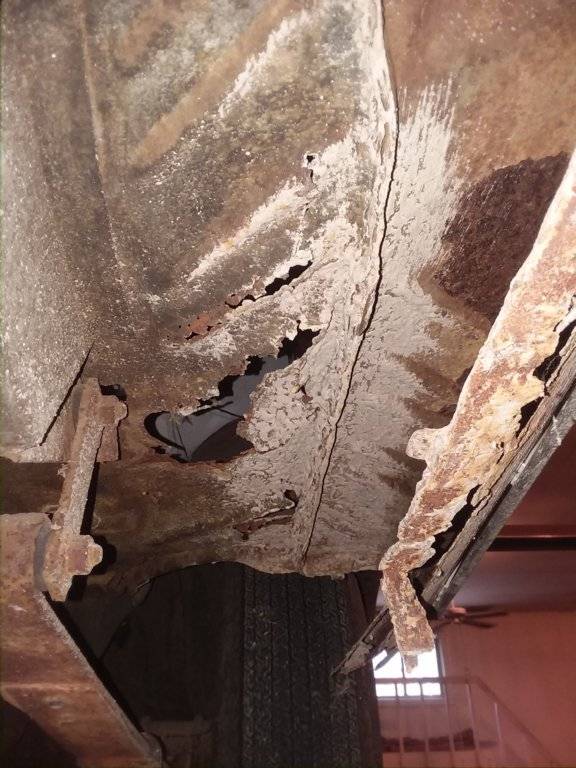

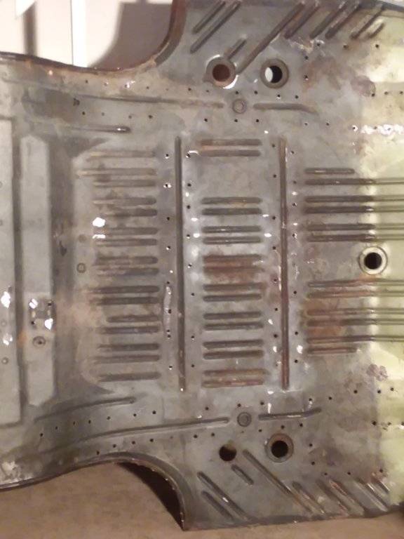

Cars been sitting for years waiting it's turn... just started working on her. Only part time so this will take
a while.
Just finished dropping the old fuel tank, and drilling out my new trunk floor... 6 combind hours to drill out this pan and separate it from its original donor frame.
Been there done that. Nice job, and nice condition donor pan!
I was able to get mine out of the donor car in one piece, but it was impossible to put into the recipient car in one piece. Had to slice it down one frame rail (between the spot welds) to get it in.
Nice work. The donor car must be pretty clean.
