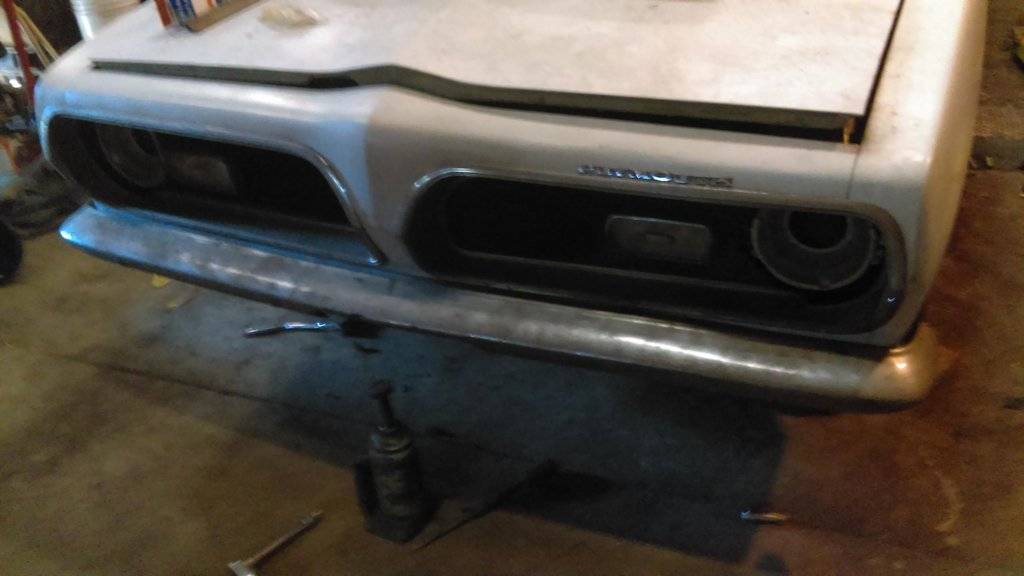

Yes still on hinges and springs, hard to find a 69cuda/73-4 dart one piece fiberglas, thought about converting to a 67-68 flat nose grill shell but never happened.
I never noticed til Recently but 69 are much Nicer with that little bump on the Nose.

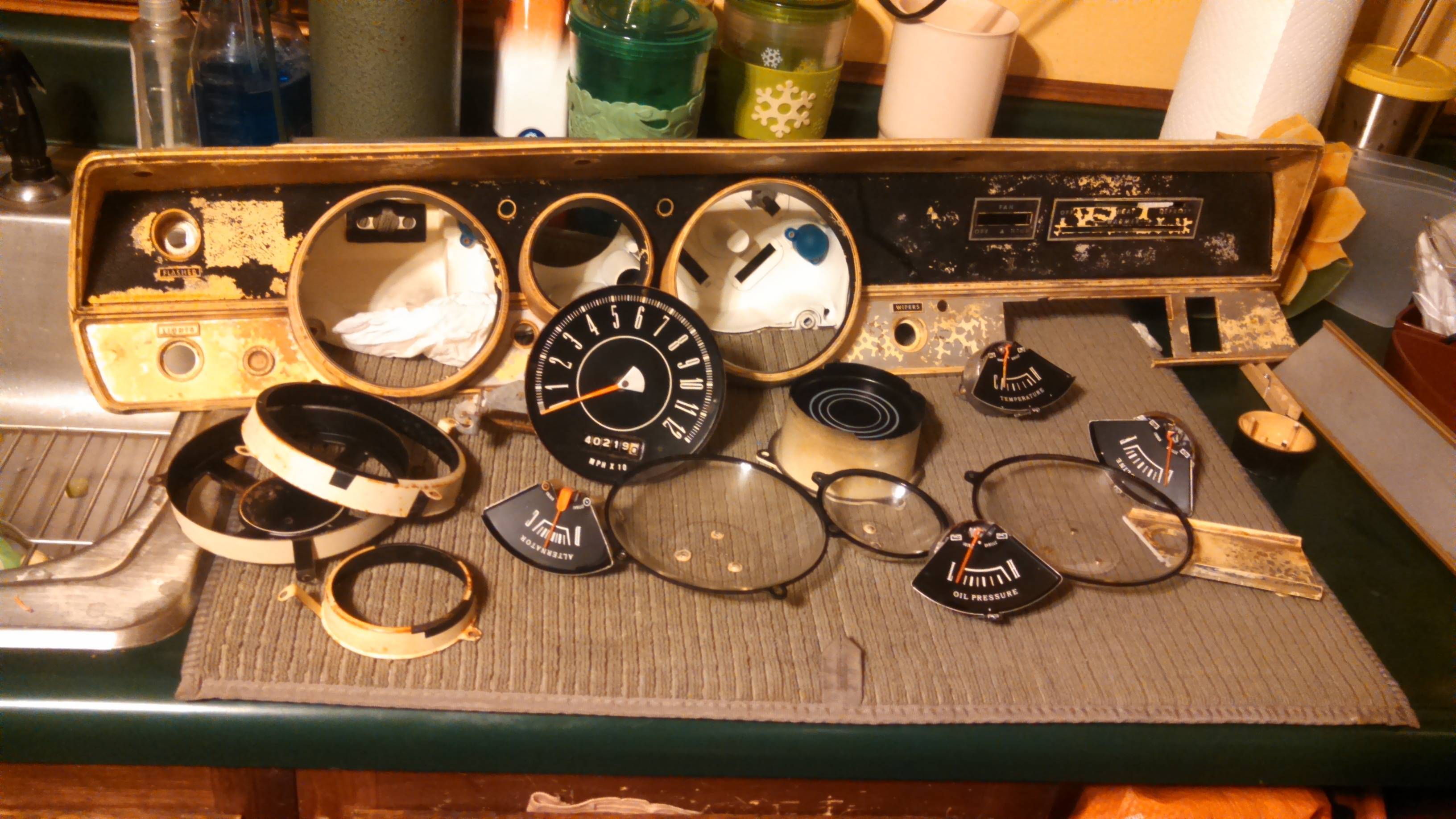

I don't think it got out of single digits today so a little inside work. Got the instrument panel apart to clean, repair, put some new paint and inserts. Plan is to put a panel in where radio was, hide butchering, eliminate the heater controls embossing, trim the whole thing in black with a silver carbon fiber where the black and flat silver is. This is the before shot.

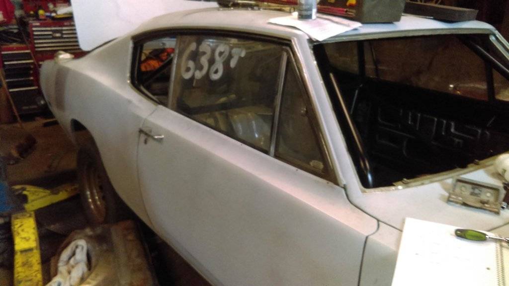

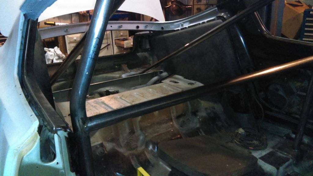

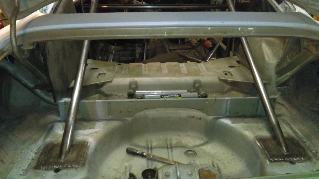

Alright, I got some life crap out of my way and have changed course on this a bit. I decided to put a cage in it now before paint, for obvious reasons. I bought a roll cage kit (mild steel) I have been lining it up location in the car per driver seat. Will get some pictures.

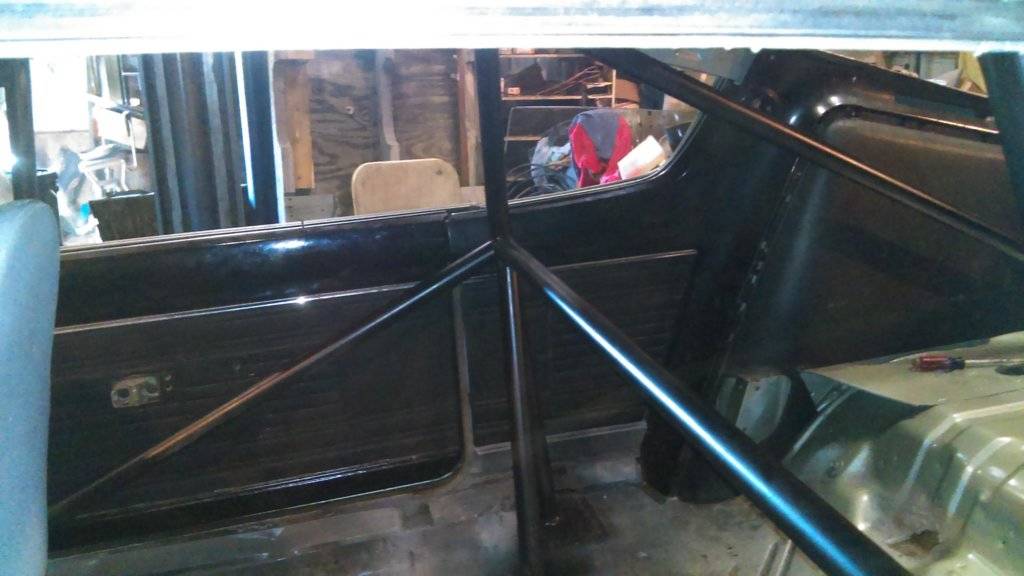

Once I get the dash back in then reveal clips and all the glass will be back in.

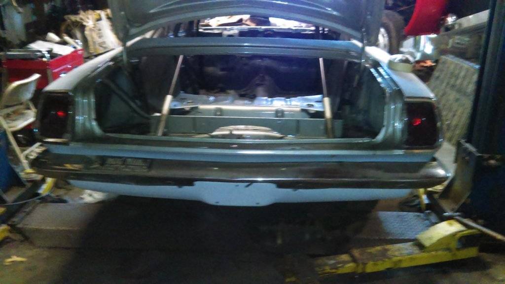

I have some holes in the firewall to weld up and repaint it engine compartment with the new bars in there and then engine and trans.
So Dave... after all this time... will the cage still be legal?
It has only been bought in the last year.
Not that I will need it certified (9.99 or less), the certification is done after it is installed in the vehicle. It needs renewed every few years, mainly looking for fatigue and alterations. The initial is more intensive, Sonic test and measuring. The cage/chasis does not have a timed out life like a harness, helmet, or fire clothes.
