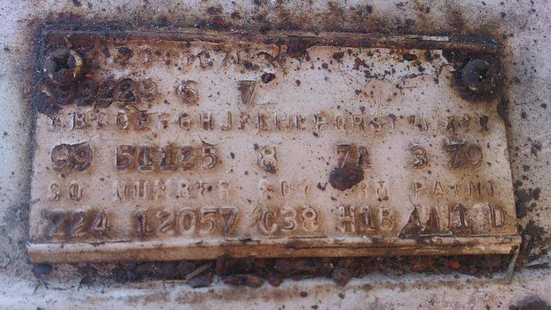

A couple days ago I was working on the fender tag list but got sidetracked. 300rag got a lot of it. Here's what I have but not sure of the accuracy (and yes, it seems fairly well optioned):
Top row:
12: Left remote outside mirror
22: Fender skirts
39: Variable windshield wipers
56: ?
87: Front bumper reveal mouldings
Second row:
AB99: Std V-8 w/PCV
D5: Automatic trans
E1: A/C w/heater
F1: Power brakes
G2: 6-way power bench seat
H5: Power windows
L8: Auto pilot
Q7: Radio search tuner + rear speaker
R1: Power antenna
V3: Backup lights
X7: Front retracting belts
Y9: Fender turn signal indicators
Third row:
SO # / invoice:
224: Feb 24, 1965 (build date)
12057: id
C38: Chrysler High (price class) 4-door Town Sedan, 6 window
