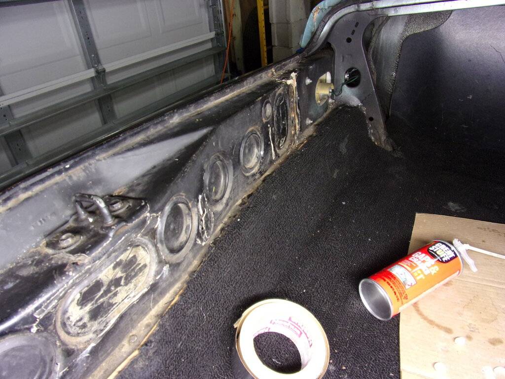

I did some investigating tonight and found that there is a valence in the rear-most area of the trunk, above the rear bumper if you will. In that valence there are a series of 2" holes to access the bulbs. Those holes are (or should be) sealed with plastic plugs. If they are not, then there is basically an open path from the tailpipe into the trunk.
I had a number of loose extra plugs that came with the car, but just then realized where they they belonged. I got them installed as you can see in the photos, so we'll see if this solves the problem.
Thanks for the help everyone, I appreciate it.
