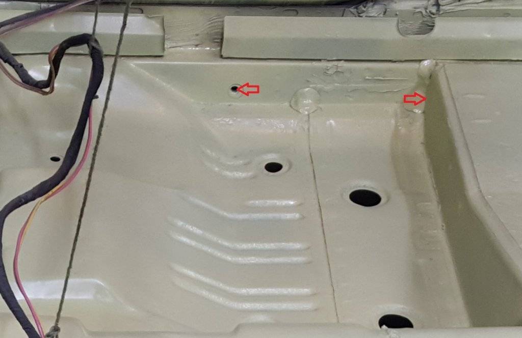

I am looking for the measurement between the two points shown on this photo from a 1970 Fury 4-door (or another 4 door with the same floor pans). If someone has their interior out and can measure it for me, I would appreciate it.

The floors on both the 4-doors and 2-doors weather sedan hardtop or convertible are all the same. The floors are also shared across the Chrysler Plymouth Dodge lines with only the filler panel (the 9" section between your arrows) being different.

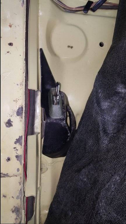

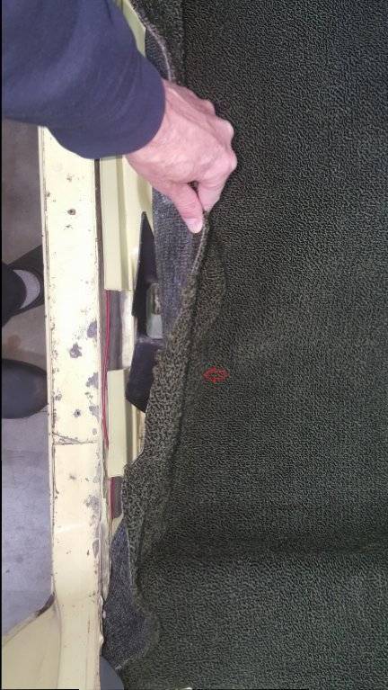

It was hard to get pics to show the problem, but the arrow in one picture shows the actual belt hump, and you can see the molded hump is in front of it. In the other one, my hand (apparently channeling Spock) is over the actual hump. I went to the ACC website and they have 2- and 4-door versions. Trim Parts does not. :(

There goes my theory. The molded hump on this carpet is about 15 inches from that shelf. My seatbelt hump is about 13 inches, or slightly less. Maybe it is operator error, as saylor suggests, but i have the carpet firmly up against that shelf. It's molded to fit the shelf so i cant move it further back.

Trim Parts has been a pleasure to work with, both before the purchase and after. I explained the issue and they sent it to the carpet supervisor. He said their carpet mold is from a two-door and the center of the seatbelt hump is 15 inches from the rear shelf. That is consistent with the carpet I received. My seatbelt hump is 12-13 inches from the rear shelf, which is also what Alan measured on his 4-door sedan. The supervisor thought my floor might be different from their 2-door mold because mine is a convertible.

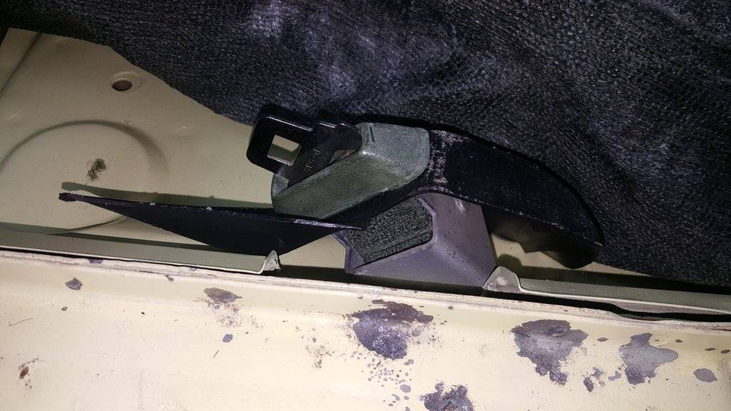

I tightened the bolts on my seatbelt assembly tonight and it measures about 11.5 inches from the center of the hump to the shelf. I'm attaching a couple pics to rule out that I am installing the seatbelt wrong, but I am pretty sure it is correct.

View attachment 125124 View attachment 125125

The first thing I thought was you might have had the seat belt in wrong, but I can't see any other way it would go in.

The flat panel just in front of the shelf drop is the difference, the panels front and rear of that are the same.
It is that 9" or so panel between the arrows in your picture.

Thanks Alan. It's about 6 inches on mine. It must be 9-10 on John's. Is the following an accurate summary? I want to share it with Trim Parts.
All models of 1970 (other years?) C/D/P use the same front and rear floor panels, but the flat panel in front of the shelf is several inches wider on C and D. Within a division (C, D, or P), the floor configurations are the same on all models. The four-door hardtop may have a different seatbelt configuration, but the spool should be in the same location as the other models.
Translating this to my rear carpet, it would fit fine if it had another 3-4 inches in the rear footwells.
