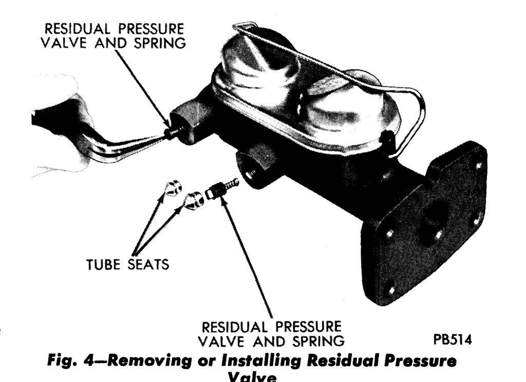

@MN72Fury ... the 50/50 master is so the rear brake circuit won't run out of fluid, it isn't so special otherwise. It is possible to use a rear drum master from a Formal (and many other cars) but you want to remove the residual pressure valve from the port (if one's there). This stuff is shown in the FSM, but for repair purposes... don't expect a tutorial for modifications.

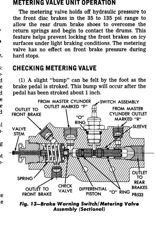

Metering valve could cause the opposite effect of what you described
